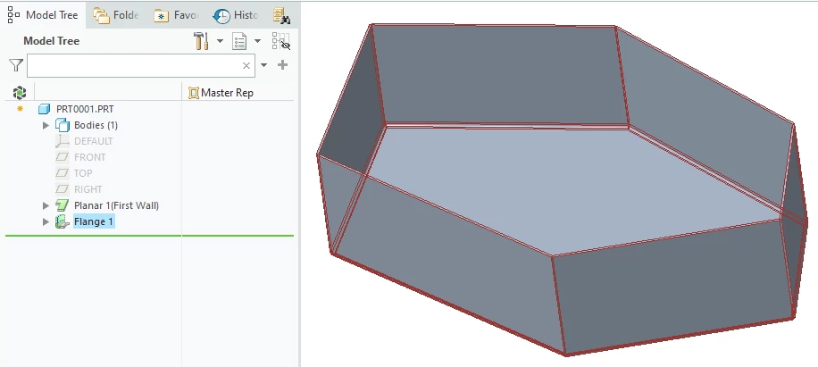

Can you provide more information or a picture of what you are trying to create.
Based on your description, a Flange can create this:
All angles must be less than 180 degrees to unfold correctly though Creo will create the formed part with an angle less than 180 degrees.
