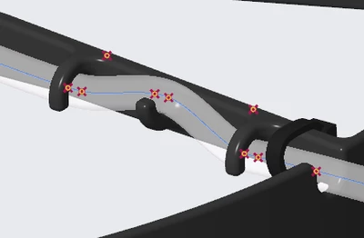

Dec 6, 2023 3:25 PM UTC
For this problem, I create a series of points, using either existing model features to define the point location or using points from offset coordinate system if there are no features to define the point location.  Then use the Curve Thru Points function to create the path.  Most of this is done in ASM mode using surfaces (for the visual representation) and I use bulk parts to drive the BOM table.
