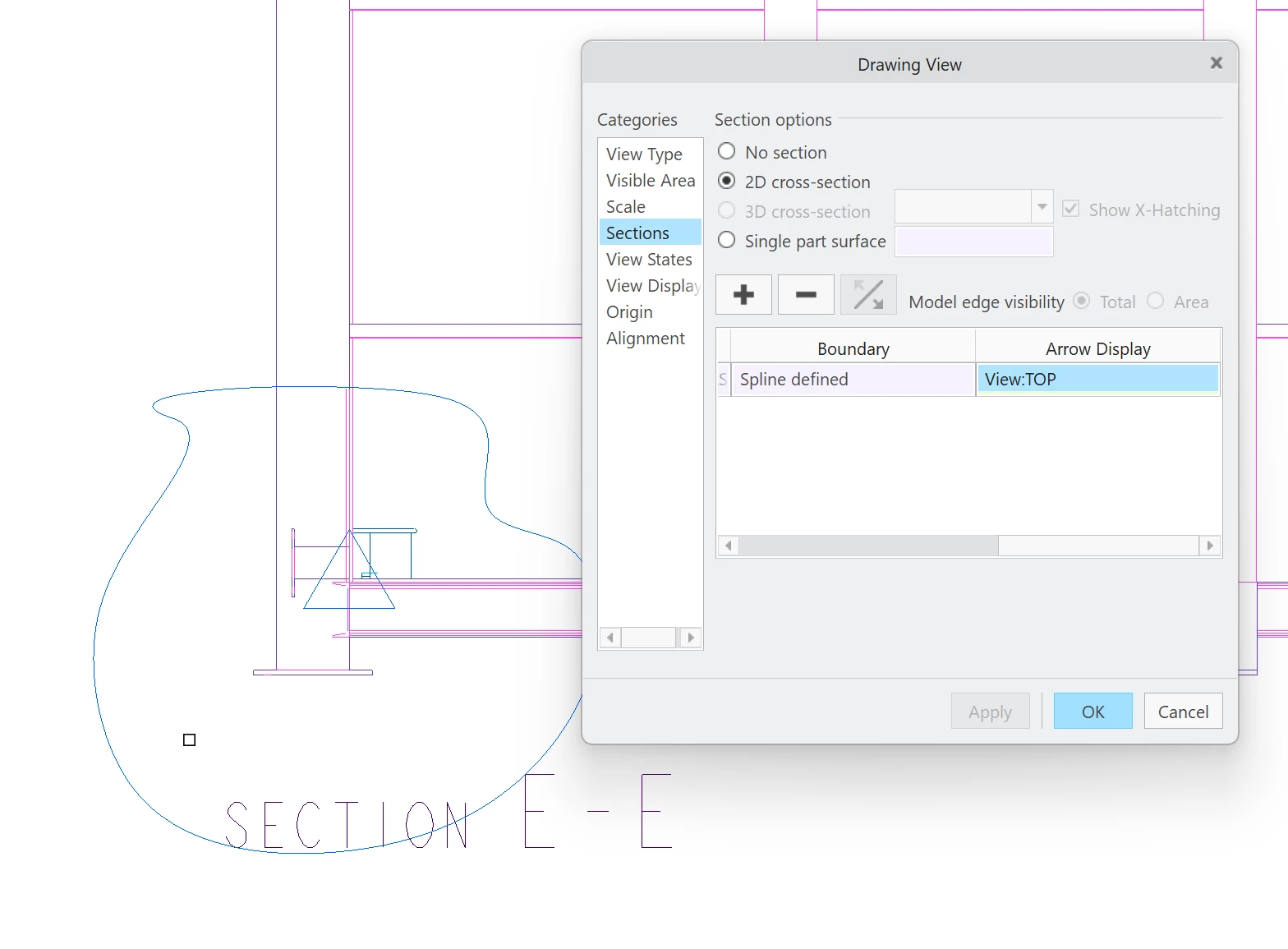

I created a local section view on a model back view and I can't get the spline that demarcates the edges of the section view to show up. The spline only appears when I have the dialogue box open for editing the view. As soon as I close out the box, the spline disappears but the section remains. I would like the spline to remain on the view. How can I do this?
7-Bedrock
I can't recreate the part at this time so I ended up adding a spline sketch that follows the spline used to create the local section. This accomplishes the problem I was looking to solve.
