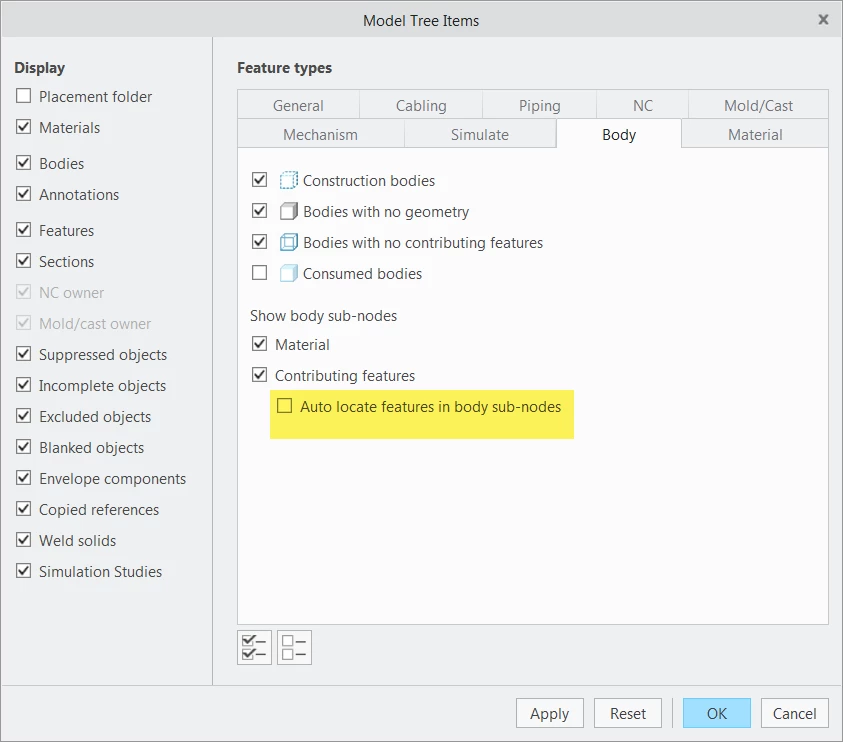

I am making changes to the model tree in Creo 7 and want to save them. Documentation indicates that it is automatically saved to a .ui file but I can find no evidence of the file being written. Can anyone direct me to an actual accounting of how this is handled?
From support article:
For Creo Parametric 6.0-
Select Model Tree Settings User-added image > Tree Columns... or for other settings select Tree Filters
Move required column types from Not Displayed to Displayed > Apply > OK
Starting with Creo Parametric 6.0, the model tree settings are automatically saved in a *.ui file.
This is one setting I am changing but it is not persistent when restarting Creo.

I tested Creo Parametric 7.0.9.0 and it is able to set and remember highlighted option.
Try using Creo without customization, i.e, config.pro, ui files, and so on.
By default UI file is saved in <user>\AppData\Roaming\PTC\ProENGINEER\Wildfire\.wf\.Settings directory.
See https://support.ptc.com/help/creo/creo_pma/r9.0/usascii/#page/fundamentals/fundamentals/about_saving_ui_custom_settings.html page.
When PTC_WF_ROOT variable is set UI file is saved in %PTC_WF_ROOT%\.Settings directory.
