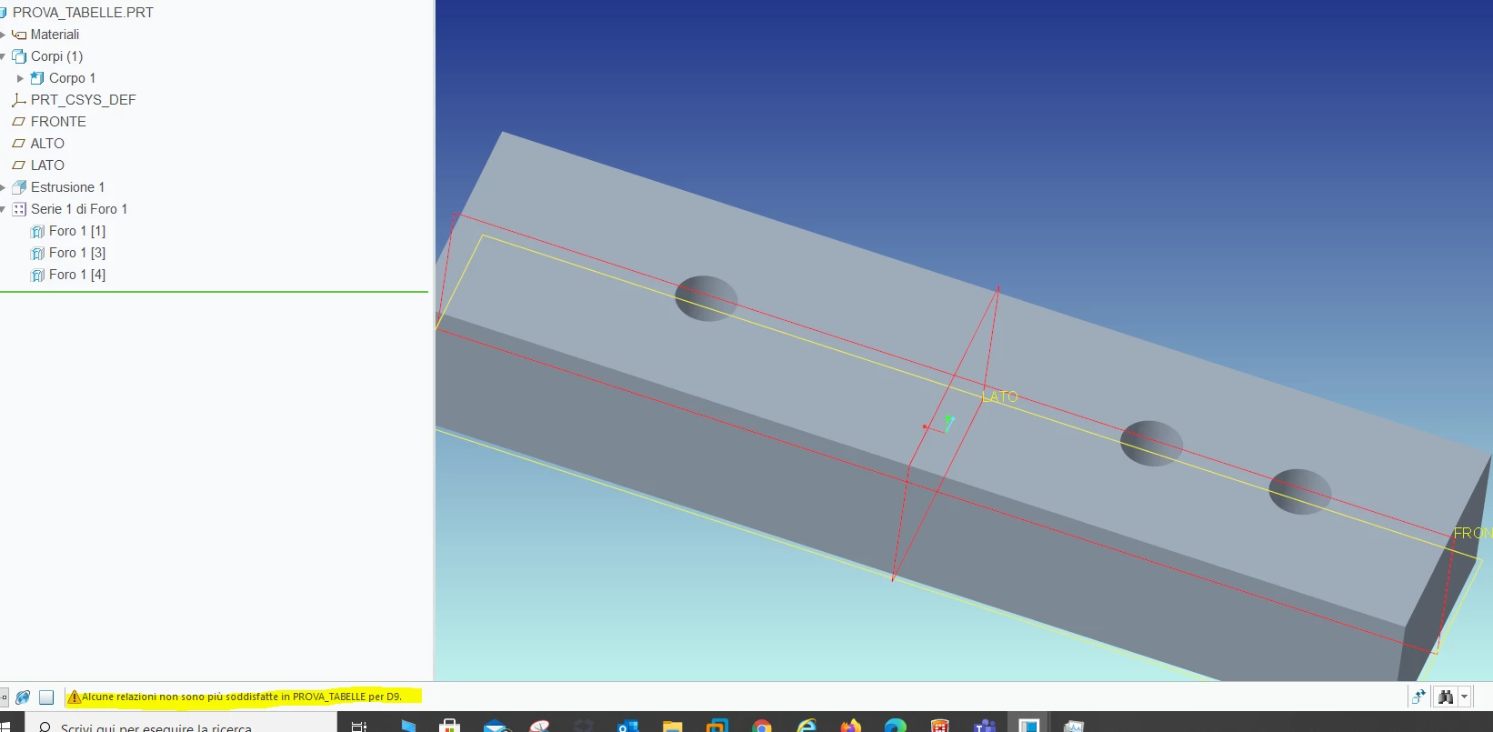

I was testing some files with pattern tables linked by relationships and parameters in the Creo 7.0.1.0 release
If I go to modify the parameters DIST1 and DIST2 in version 7.0.1.0 they don't change and compare the message you see in the attached photo.
In version 5.0.6.0 and 6.0.4.0 everything does not work correctly.
Because?
I am also attaching the model.
Matteo.

Wow, definitely seems like a bug, and a pretty serious one at that.  Creo 6.0.5.0 works fine.  Creo 7.0.1.0 definitely does not.
Someone should open a case with tech support.  Would you like me to contact them or would you prefer to contact them yourself?
