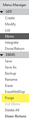

Creo 7 purge UDF files (,gph)
Does anyone know how to use the purge function on subordinate UDF files (.gph)? The UI is the old menu manager, and I am not able to find instructions on how to actually operate it. I am able to purge the reference model that is driving the gph file, but the UDF purge seen below I am not able activate.

tbraxton
tbraxton22-Sapphire IIAuthor
Oct 5, 2022 4:58 PM UTC
@MartinHanak using the command line to run will purge all files in the directory where purge is run, will it not? I was attempting to purge a specific UDF file, not all files in a directory.  The UI command in the menu should only purge the selected object (a single .gph file)

Holy moly...I haven't seen DBMS-SAVE in...wellllll... probably 25 years ago!!
