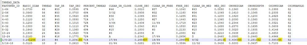

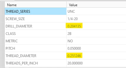

I'm not seeing this problem in Creo 9.  If I modify a .hol file to include values out to six digits, all of the digits are used in both the hole parameters and the final hole sizes.
Extra digits added for testing:

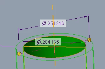

Hole feature parameters:

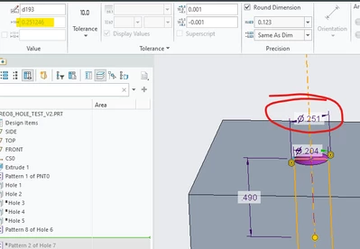

The precision is still there, it's just that the display is normally rounded to three decimal places:

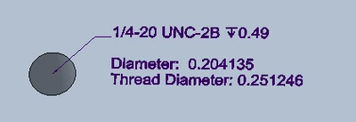

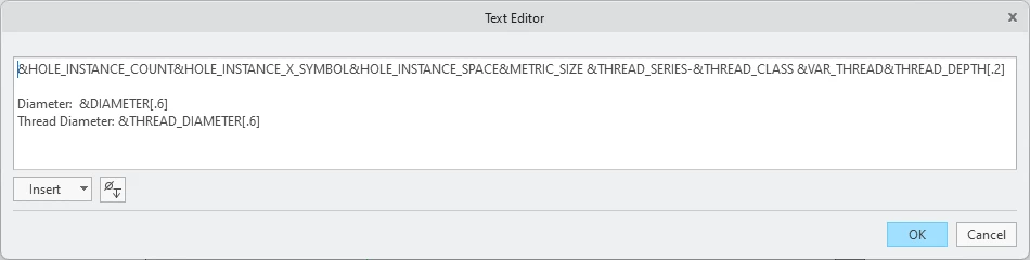

Using the standard parameters in the notes with the [.<number of decimal places>] syntax will show more than three decimal places.
While I would need to do additional testing to see if it's possible to have everything default to four decimal places upon creation, it does seem like the precision you need is already available, at least in Creo Parametric 9.0.

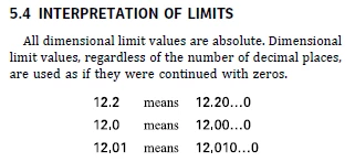

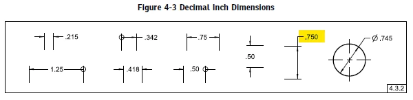

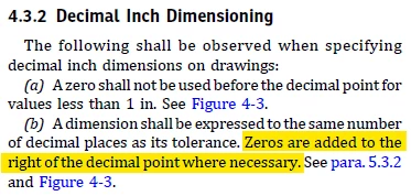

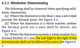

I'm aware of this for metric values, but I'm not seeing the same thing for inch values.  From what I'm seeing in ASME Y14.5-2018, metric values must be truncated but inch values do not need to be.
Metric
Inch
Regardless of whether or not trailing zeros are present, the interpretation of limits still applies:
The way the hole feature in Creo is currently implemented, I don't think you will be able to get a different number of decimal places automatically displayed based on fastener size.  While there should be no problem making all of them 3-place, or making all of them 4-place, it would probably take an enhancement to get both (either one) at the same time automatically.
