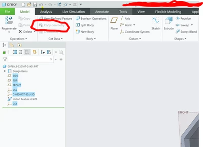

Creo 9 Copy Geometry Command
In Creo 9.0.7.0 the  Copy Geometry Ccommand is greyed out, How to activate this button so our users can use it?
Without using up the Creo Advanced Design License

This functionality requires a license to enable it. You need to have the AAX (advanced assembly extension) or another license to enable it, it is not included in the base Creo licensing.
