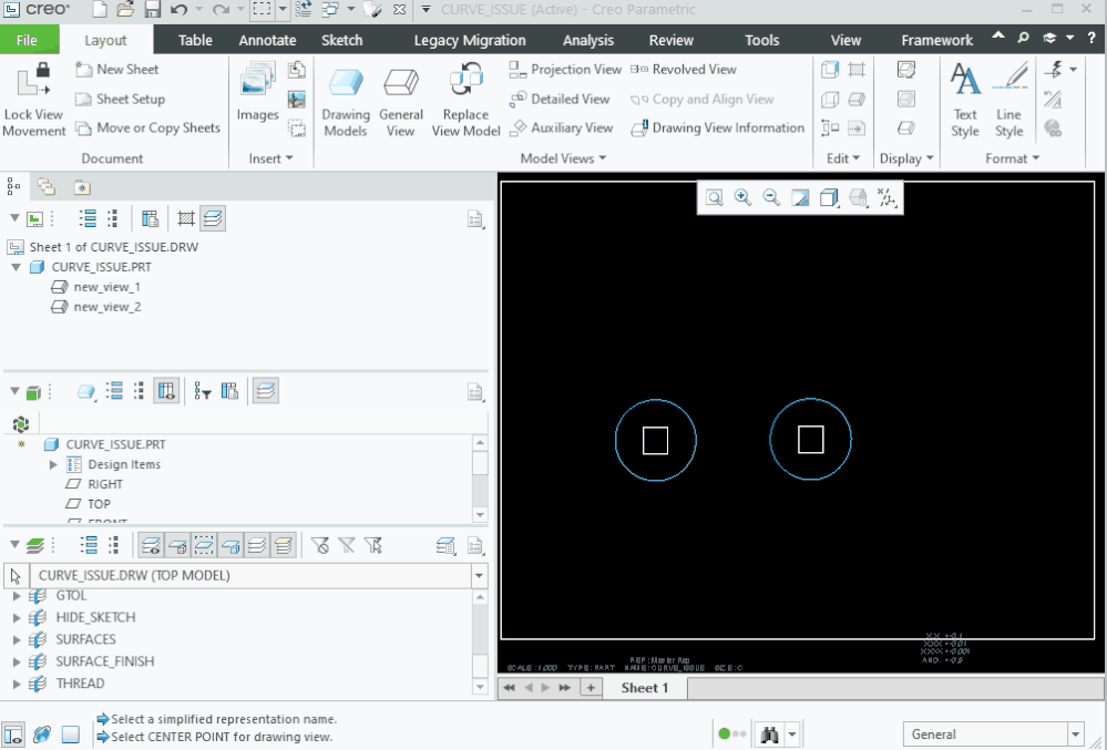

Creo 9 layer bug with curves
I just opened a ticket but this looks like a bug and I am wondering if any of you have encountered this and have a good work around. It looks like in Creo 9.0.7 its not respecting independent layer status. When I try and hide a curve in one view it effects the top drawing layer status even though it is not set as such.

fasthlr_drawing yes
was accidentally set. It was removed and the issue has been resolved.

It MIGHT be because you might have the curve on more than one layer.  I use "Rules-Based" layers to prevent that.

That curve is only on one layer. I confirmed it with the feature information report.

fasthlr_drawing yes
