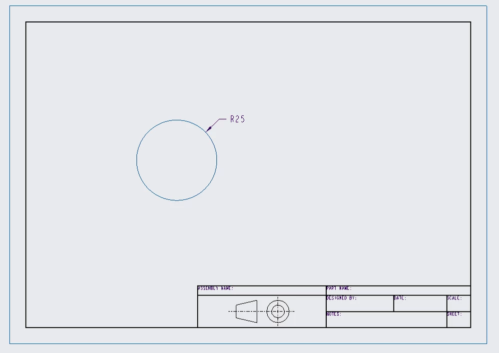

Hi everyone,
I'm experiencing an issue with Creo 9.0.1.0 Parametric Educational Edition, as the program does not let me export drawings in PDF format if they contain certain symbols.
For example, the following drawing is exported correctly:

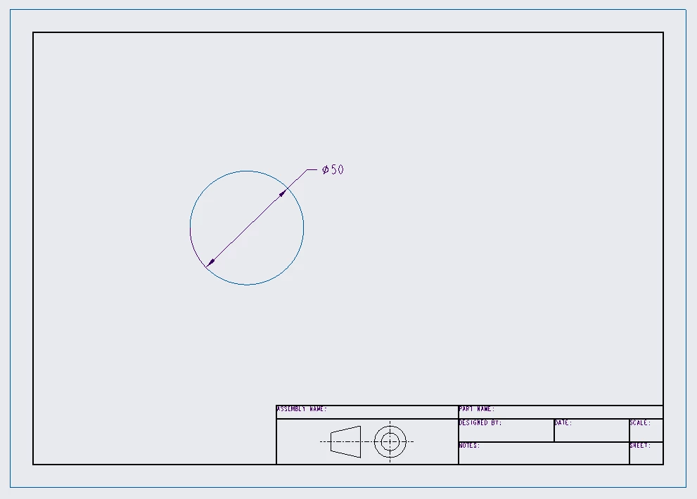

While if I change the radius dimension to a diameter one, containing the symbol  Φ instead of the letter R, as in the following:

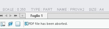

I get this error:
And the export is not carried out.

This issue also happened to me, and I could not solve it. The only way to export it as a PDF file was by sending it to print and save it in that environment. I hope it can help you with this issue
Nov 3, 2023 9:51 AM UTC
use Save As > Save a Copy command, select *.pdf extension and in PDF Export Settings dialog box activate Content tab and select Stroke All Fonts option.
