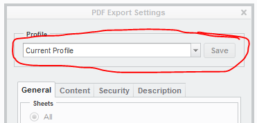

And when I set the Save-As/Export PDF settings, there's no place to save them so they are the same settings each time I have to start Creo (after it crashes, usually)
You can save your PDF settings.  Granted, Creo won't automatically read them in, but once you've manually selected the saved saved settings once, Creo will remember the settings for the duration of that session.

The second setting is still a problem as I still have to remember to reload the setting, which on a hard deadline when Creo crashes and I need to get back to redo the lost work and still progress is just one of dozens and I'd like to not have to remember to do so. I am certain to have noticed it, but since it isn't set-and-forget, I discarded it from memory. No use remembering a setting when I have just as far to get to it as to do what it controls.
When I had access to AutoIt I could make any number of customizations, like moving windows that block other windows and make selections without having to go through the nearly 2,000 creo config options and guess at possible names or which might be useful. I liked that I could make AutoIt as smart as I needed about making those changes.
