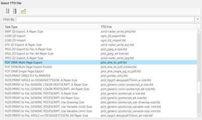

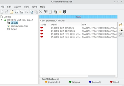

I have some problems with Distributed Batch, I'm using PDF DRW MULTI PAGE EXPORT to convert some drws to PDF.
But it fails then can't proceed,

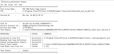

Here is the log file

Hi Tuan,
in my case it helped, to set the language of the batch to english:
try to add:
set LANG=US
to ptcdbatch.bat
