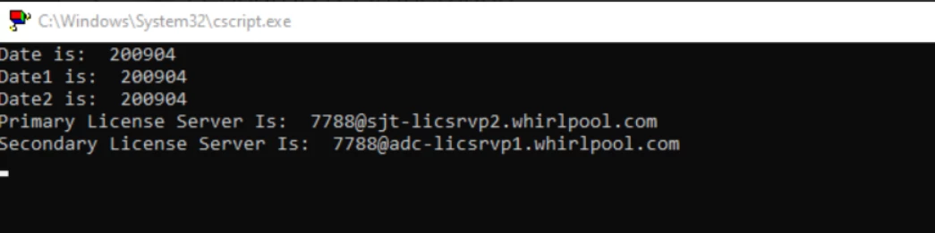

Creo doesn't start showing license server and date
Hello all,
Hope you are doing well..!
I am facing a problem while opening creo since yesterday where a window is popping up. it is not allowing creo to start. see attachment.
Cersion--> Creo 7
please help..!

Jan 19, 2024 5:17 AM UTC
Hi @MartinHanak ,
Problem solved after reinstallation of creo.
thanks,
Sandy

How are you launching Creo? Are connected with VPN?
it appears as though you have lost a connection to your license server, I would contact your administrator, also check your firewall settings and make sure ports are open.

does this mean that two days ago Creo worked and today it does not work?
Please run ptcstatus.bat and show its output.

in Parametric\bin subdirectory ... in my case it is E:\PTC\Creo7_050\Creo 7.0.5.0\Parametric\bin
