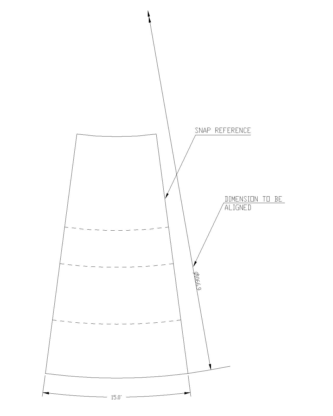

I think an image for clarification is in order here.
February 6, 2015
here's the image....
The diametrical dimension needs to be snap at a certain angle or any from the parts edge.....need help here

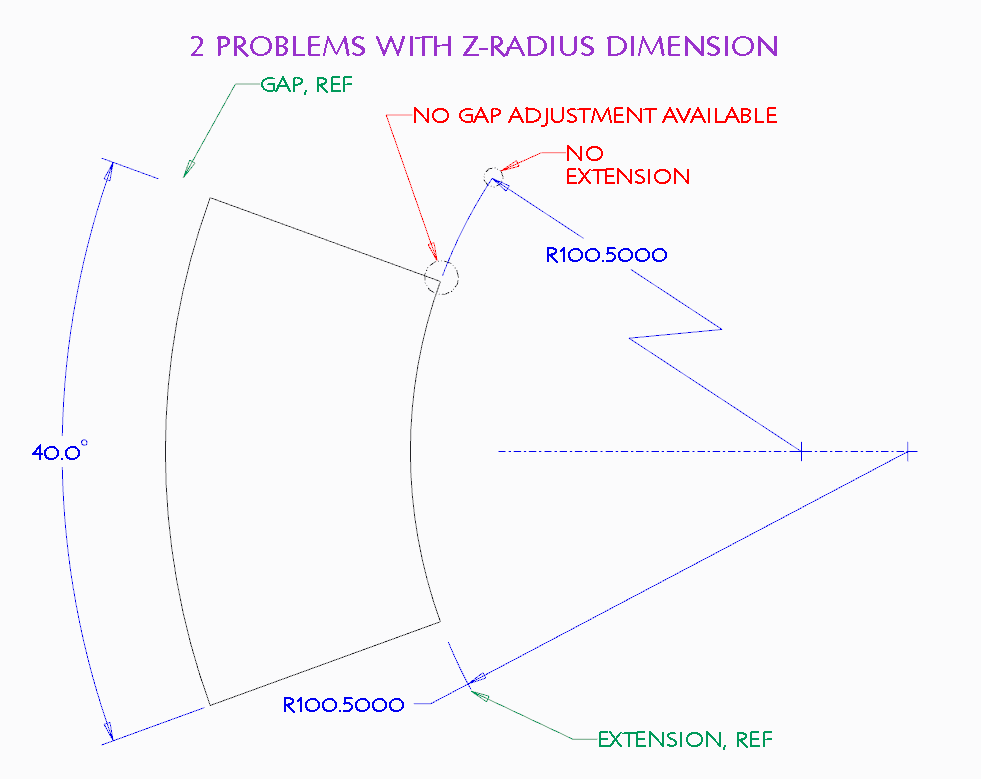

I wish a lot of features in detailing were more intuitive.
Typically, this dimension would be specified as a Z-Radius so you can show a centerline mark.
Even that has a bug in that it doesn't draw the tail correctly and draws an arc on the opposite side.
If you have active maintenance, feel free to create an idea for consideration.
edit: I reported the Z-Radius issues... below is Creo 3 ... Creo 2 also adds an extension line to the opposite side of the part.
