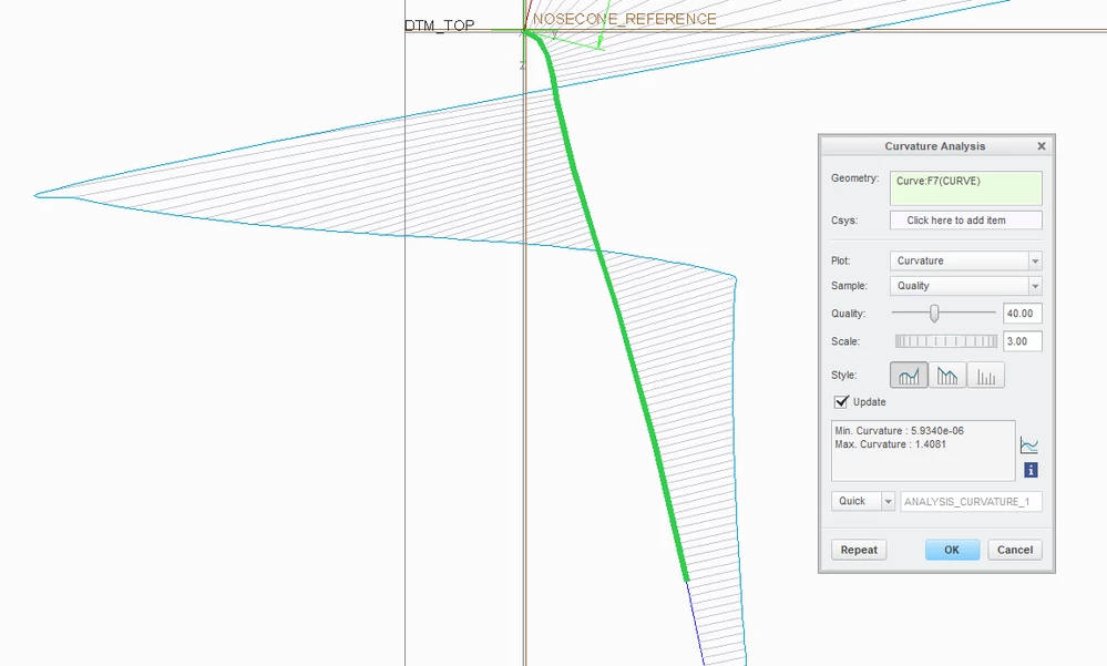

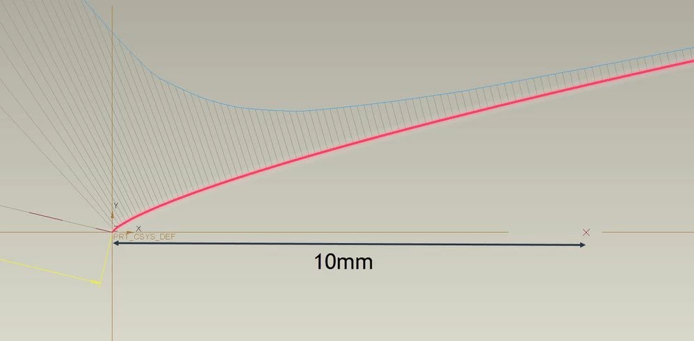

So here is the problem: zooming in where the observed segment of the curve spans about 10 mm of length, there appears to be a small concave segment and the tip seems to blunt abruptly:
The gradient should always be decreasing, yet by visual inspection and the curvature analysis tool, we can see this is not the case.

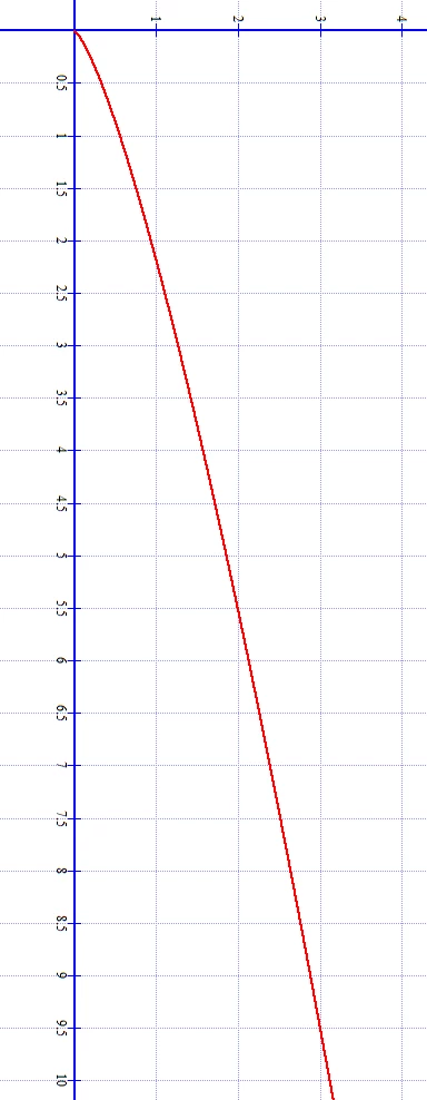

This is how the shape should look:
I've attached an excel plot of what the values should be for the length of the cone. Creo more or less agrees with the numbers until it gets within less than 20 mm of the tip where the concavity and weirdness starts happening.
Why is this happening 😞   ?

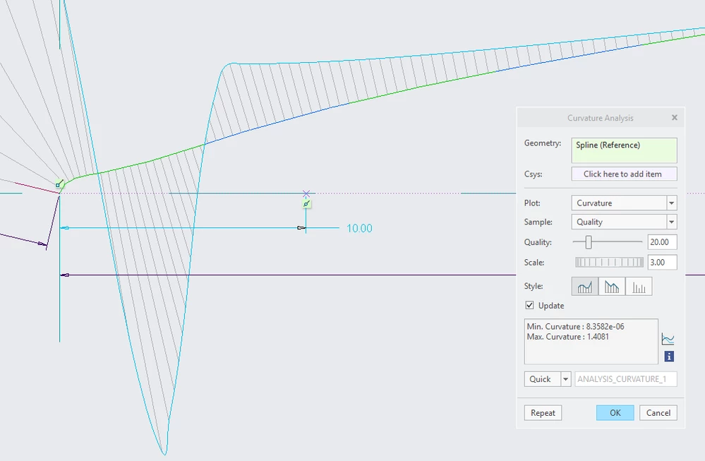

Curvature analysis of 0-10 mm of curve. It does not look like what you have posted. Creo 4 M060 build.
I have used this curve to generate a surface and the reflection curves also do not indicate the inflection of the surface near the nosecone.
Curvature plot of curveCurvature plot of curve
