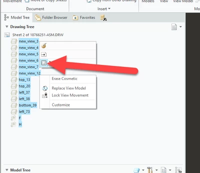

StephenW
Aug 29, 2023 11:34 AM UTC
Select the views in the drawing tree, select the top, hold shift, select bottom, then RMB resume views
