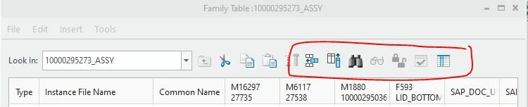

Creo Family table verify instances disabled.
Hey there,
I am experiencing family table error as the verify instances options is not enabled. Is there any easy way to fix them quickly or what creo tries to communicate about it? Please have a look at the attachment.

It is disabled, when there is a failed feature. It prevents you from verification that will fail in the end.

Just guessing based on not much info, if you are using PDMLink, one or more of the instances or the generic is not Unlocked in the workspace.
Oct 23, 2023 2:33 PM UTC
Are all instances checked out?
I always do a change that forces the whole family table to be verified, either when adding new instances or modifying an existing one.
