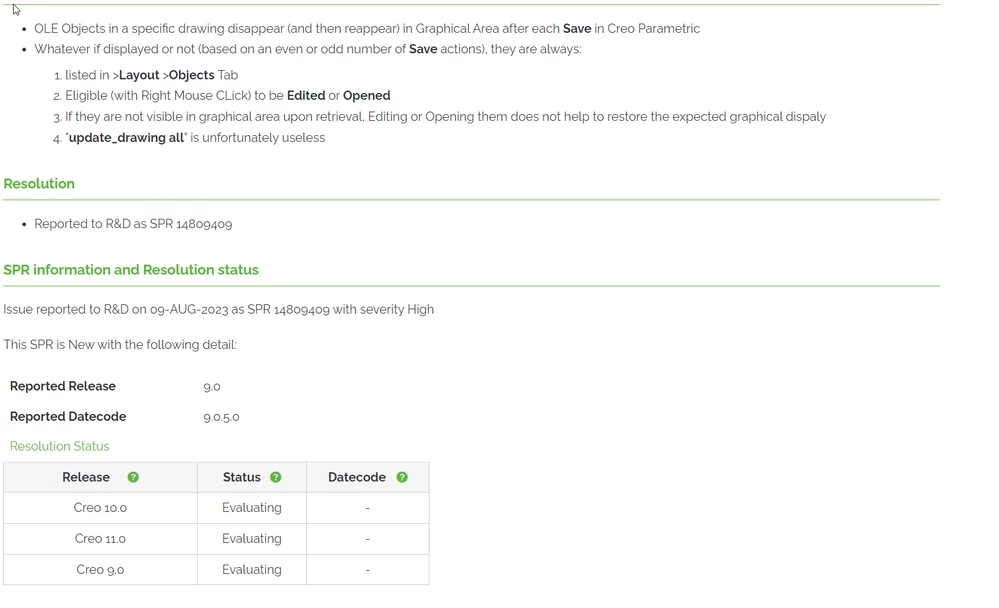

Hello @Model_1975
This behavior is reported as a SPR and documented in an article  CS398628
Sep 22, 2023 1:54 PM UTC
@Abhiram_Pande wrote:
Hello @Model_1975
CS398628 is not accessible.
