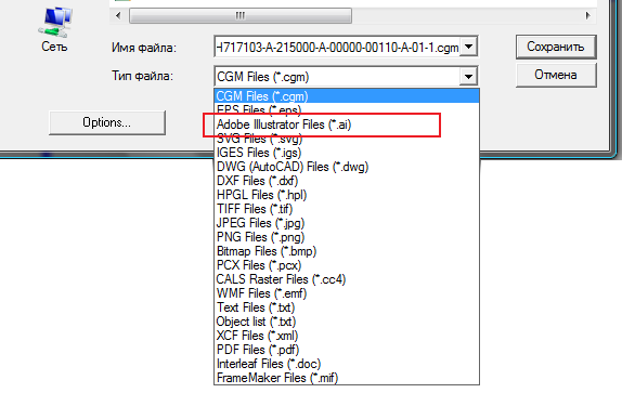

Could you attach this "CGM" file? Also note that Arbortext IsoDraw can export files in Adobe Illustrator Files ".ai" format:
