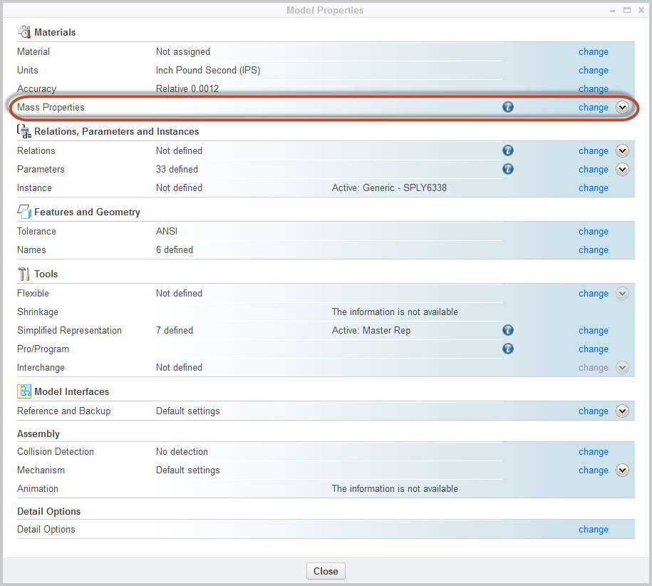

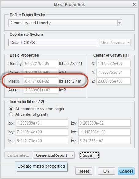

  • I don't understand enough about the Mass Properties work to know if this would be a solution. Does it go through and recalculate the mass properties for the lower level parts? This would only give me the level weight and I need the info for every component.

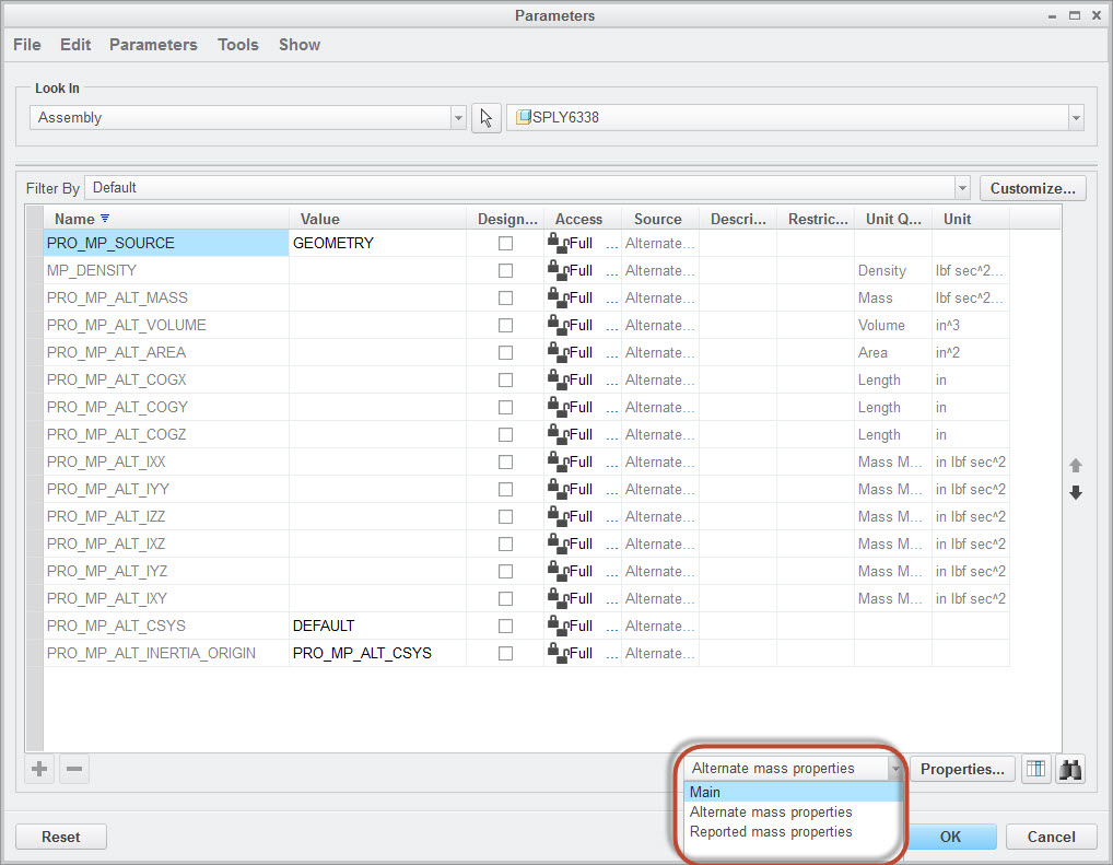

Related, I don't know the difference between these mass property parameters... Alternate vs Reported Mass Properties.mass_props_2.jpg

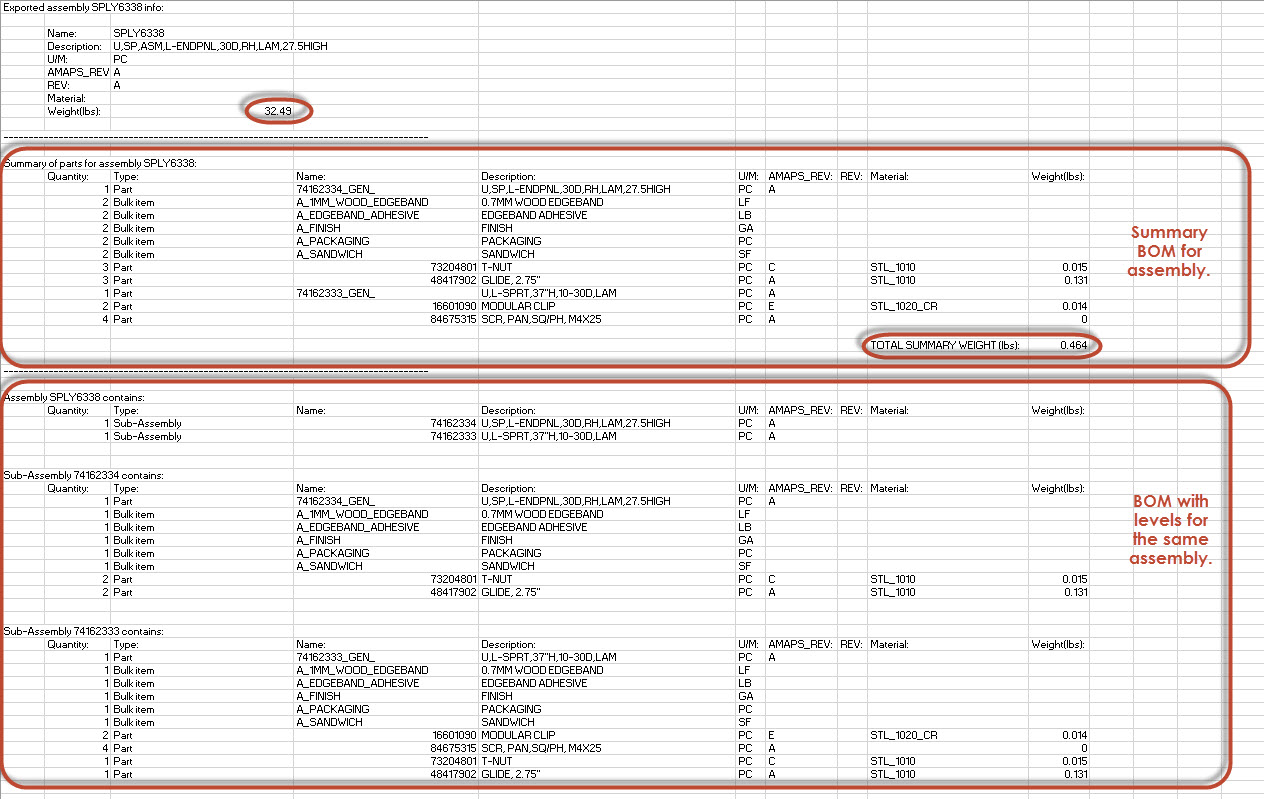

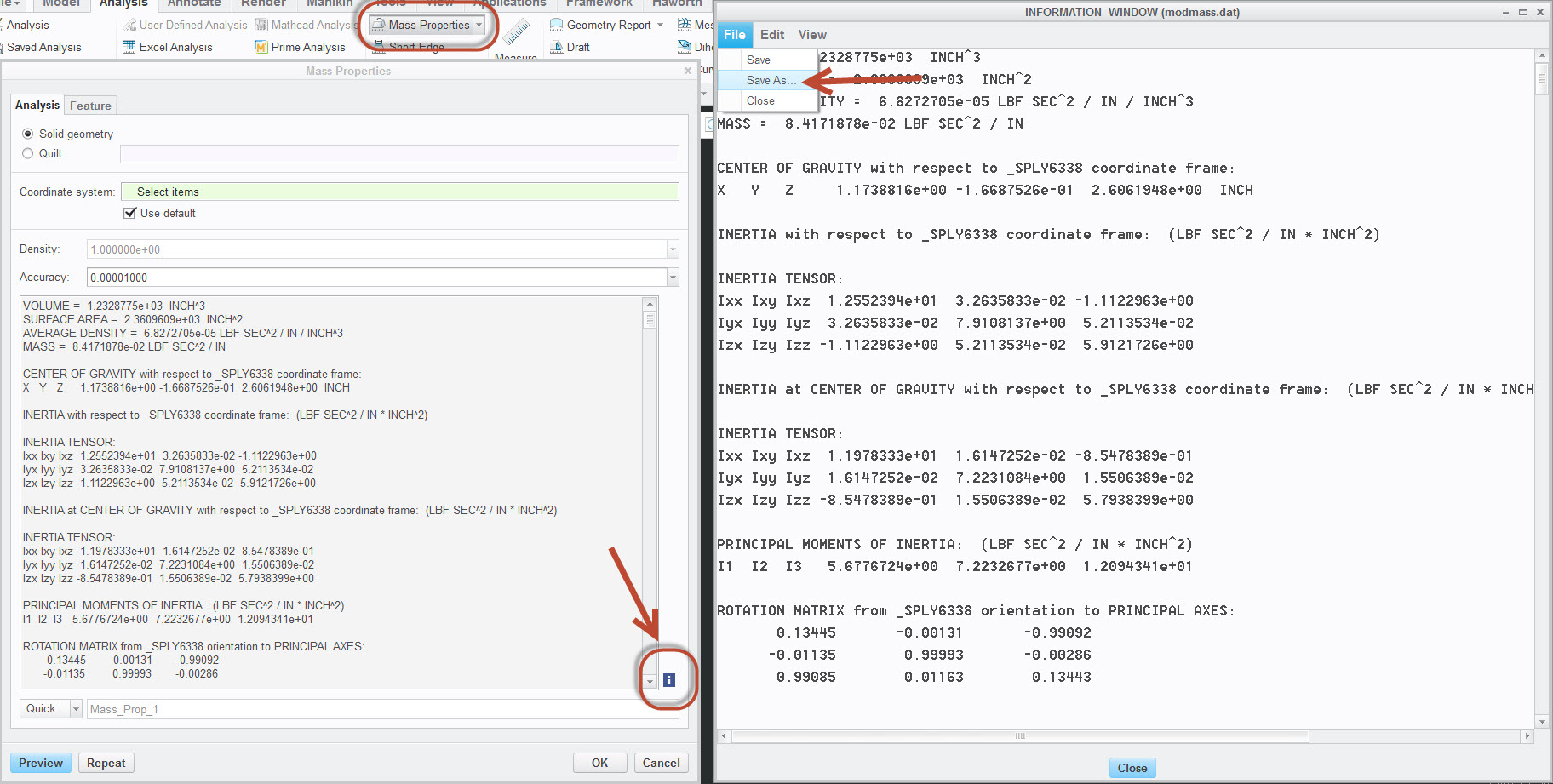

CHRISTOPHER REES It looks like you had quite the discussion earlier about trying to figure out basically how to do the same thing minus exporting the name of the assigned material and any kind of desire to get this info into Windchill. I'm confused about what you mean by it doesn't report out the part level... you can save the mass properties file as a txt file instead of the m_p format. This seems to give all the info displayed inside of Creo into the text file including part levels. Now if only I could get it to dump the assigned material also, choose the format to display on the fly (top level properties vs every part, choose to display the assigned units vs choose my own units/use the units of the current assembly, remove all the info i don't want, include other part parameters, etc.) and be able to export it to Excel with the values all separated. This all seems pretty easy for PTC to do but hard for us to do. Without including the assigned material in this export, it's pretty worthless for what I'm trying to do (sustainability calculations with percentages of each type of material, find which parts go to which type of suppliers, etc.). Here's a screenshot of creating a text file just make sure you add the .txt when saving.
I've been playing around with the custom format for the Creo BOM tool and I can get a dump that looks super close to what I think we both want. It gives both a flat summary of the assembly as well as a BOM with levels and I'm able to exact our other standard parameters such as description. The problem is that this method requires every part to have parameters for the hidden PTC_MATERIAL_NAME material and the desired mass properties. You have the make sure the mass properties are perfect inside every part which is a problem with a Windchill controlled environment where I can't change every component. I'd probably want to add other things like surface area, density, etc. as needed.

The report does not give you the part level. Below is an example of what the report gives you. There is nothing to tell you how deep into an assembly that component is. There is no way for you to know if it reports to the top level or is buried in 7 sub-assemblies. Also mp_calc_level all_models does not slow anything down. It is very quick even for very large assemblies. Adding analysis features to every component will significantly slow things down because they will be recalculated every regen. If that is what you want, you could simply set mass_property_calculate to be automatic or check_upon_save.
