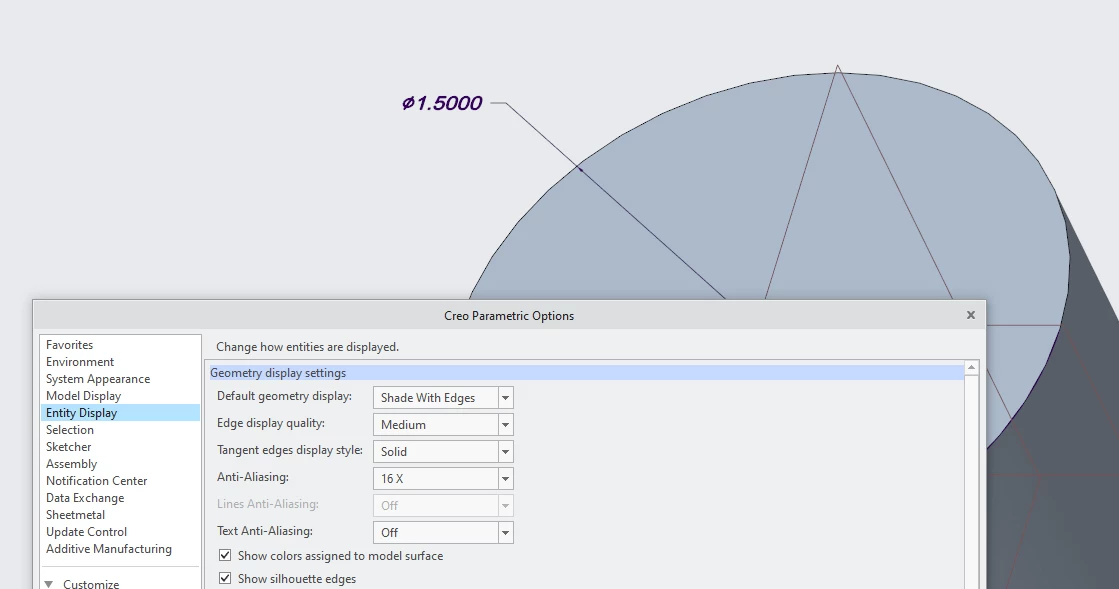

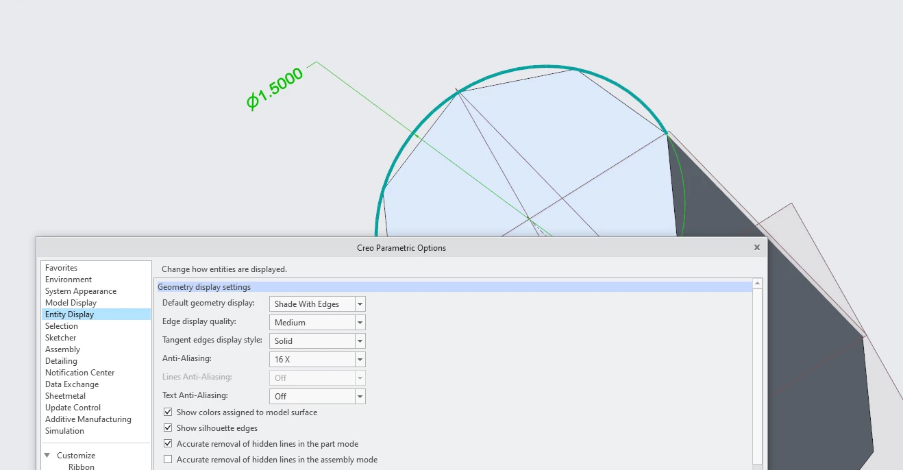

Note in the attached images that a "Medium" edge display quality on a 1.5" diameter cylinder is acceptably smooth in Creo 6 whereas the "Medium" edge display quality for the same part in Creo 8 is unacceptable.  Of course, there is the option of "Very High" in Creo 7 & 8 also result in unacceptable edges.

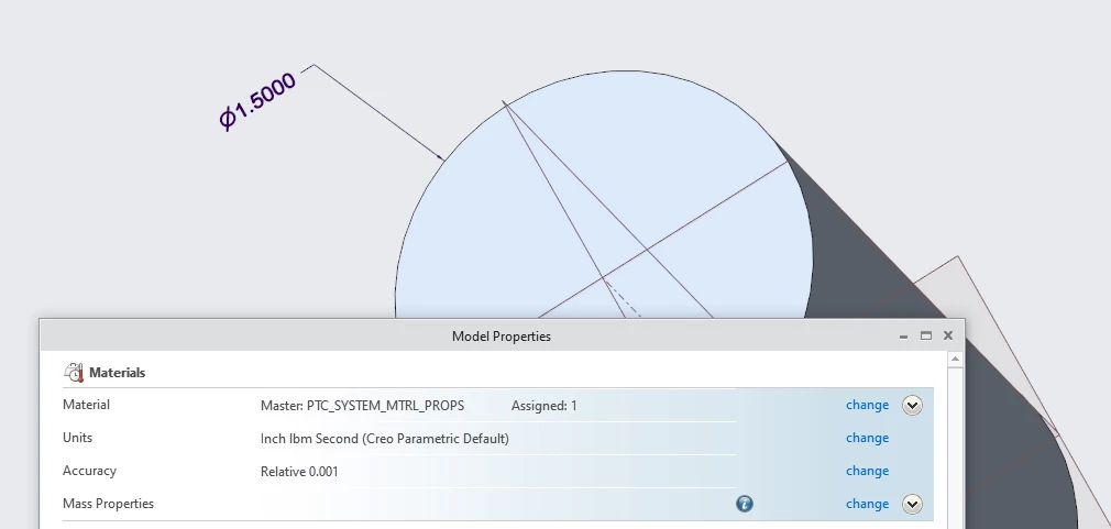

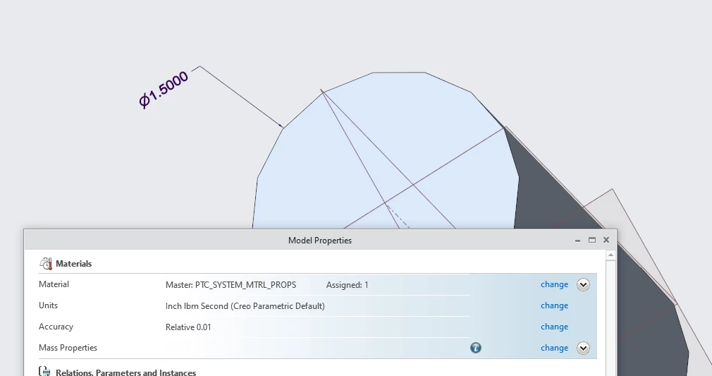

In the meantime, I discovered a way (perhaps, the preferred way) to fix this, within the Model Properties panel.  Under "Model Properties", "Accuracy", is a change option for either Relative or Absolute accuracy.  Note in attached images for this 1.5-inch-diameter part, the edge facets when relative accuracy is 0.01 versus 0.001:  visible curved edge facets to a smooth displayed edge curve.

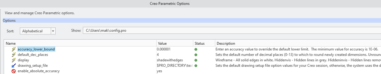

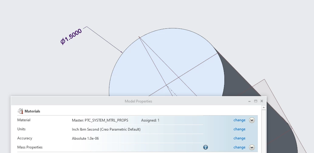

Of course, as one can set the Absolute Accuracy, accuracy_lower_bound parameter, in the config.pro to some value; in my case to 0.000001 or 1.0e-6, then the display edges are visually crisp.  Note also, that the enable_absolute_accuracy parameter (which was used in Creo 6) and left over from my previous config.pro file, is no longer recognized in Creo 7 or 8.

I am aware that default accuracy settings changed from Creo 6 to 7 (& 8).  But whether or not these changes affected edge display quality is both unclear and without a way to fix it.
