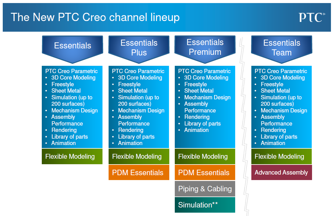

Here is an older picture, but it shows the packages pretty well.

I was thinking they might be the same things with different names, but it's hard to tell because they use different terminology.For example, in Engineer I you get "Direct Modeling Capabilities" in Essentials you get "Flex Modeling" and "Freestyle".  Is that the same thing?
Engineer II and Essentials Plus are clearly not the same since Engineer II includes a choice of 3 extentions (AAX, Design Optimization or Motion Analysis) where in Essentials you can only get AAX with Team.

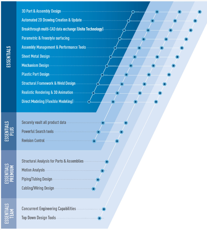

September 3, 2015
Here's the other, newer picture.  Basically "concurrent engineering" is another way of saying "PDM", and "Top Down Design Tools" means "AAX".
September 3, 2015
That's the chart in the PDF I attached.
The first one you posted makes more sense, at least it related to what I was familiar with.  It doesn't show, however, anything for "concurrent engineering capabilities", which I assume is PDM Essentials since that's part of his quote.

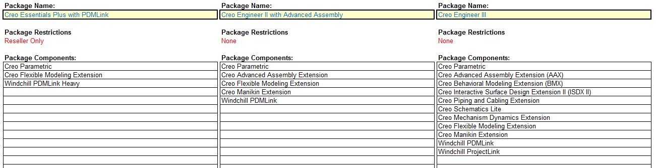

September 3, 2015
I'm probably not at liberty to share the actual comparison tool, but here is a screen shot showing the contents of three different packages.  Your VAR should have this.
