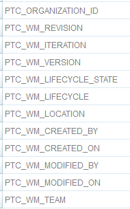

If you want to use the native Windchill parameter instead of the old Intralink parameter, it's called "PTC_WM_REVISION". There are actually a bunch of different Windchill parameters you can use.
