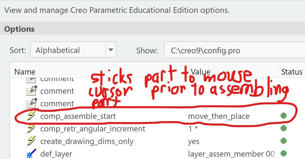

When initially bringing a part into an assembly using "main Window" mode, but prior to placing the part, can you change the default incoming position relative to the assembly, maybe there is a config setting that allows the new part to appear in the current window? Why am I asking - On large assemblies, the new incoming part enters the assembly model very far from where I want to place it (way off screen). it takes a lot of mouse work to drag it over to where it needs to be placed. Why am I not using the "Separate Window" mode in assembly? Because the separate window mode is quirky and difficult to use (parts almost always end up upside down or end up being unassembleable forcing one to use the main-window mode.

Thanks for your input, but I found out recently that there is a way to do what I am asking.
After I posted this question, I learned about the configuration option: "comp_assemble_start" which you should set to "move_then_place".
With this option activated, new items will enter your assembly glued to your mouse cursor instead of appearing very far away. I was also embarrassed to learn that this config option has bee around since the Wildfire days (over 15 years ago), but then I had been using the program before the revolutionary Wildfire version.

After I posted this question, I learned about the configuration option: "comp_assemble_start" which you should set to "move_then_place".  With this option activated, new items will enter your assembly glued to your mouse cursor instead of appearing very far away.  I was also embarrassed to learn that this config option has bee around since the Wildfire days (over 15 years ago), but then I had been using the program before the revolutionary Wildfire version.
