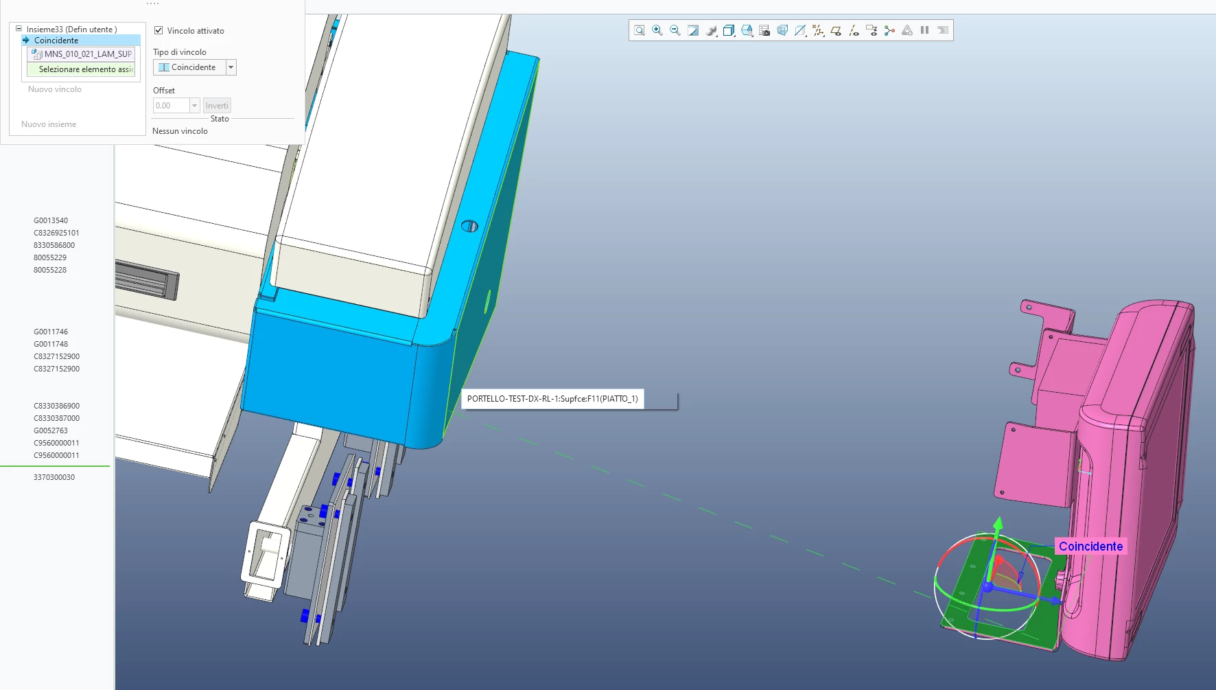

Is possible to disable or remove the dashed line that appears during assembly parts in creo parametric under edit definition ?
I want to keep the surface selection view but without the dashed line that help to position a single part for example.
I'm using Creo Parametric 8.0
(see the attached below)

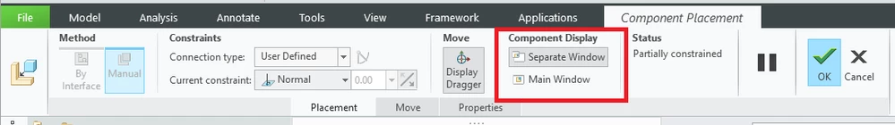

comp_assemble_start constrain_in_window
This option will start your assembly in the "secondary window". I think it is what you are looking for.

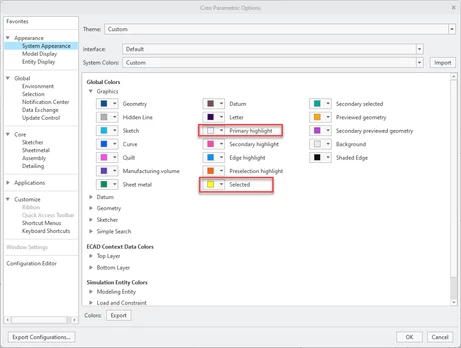

Hello
The color of the dashed line is driven by Primary highlighted & Selected
When the references are being selected, the dashed line is driven by Selected.
After selecting both references, the dashed line is driven by is Primary Highlighted
abpande_0-1697102765723.png`
config option below were also not helpful
  •  highlight_geometry
  • prehighlight
Oct 12, 2023 10:17 AM UTC
I have already try to change the options "prehighlight"  to NO, and see the dashedline during assembly edit definition disappear but I can't see no more the select surface that I wanto to move with a coincidente until I click on that surface, for example, with another surface.
I want only to disable o disappear only the dashed line wich appear during the assembly , or set to "Trasparent"  instead of colourful, if is possible.

Oct 12, 2023 12:04 PM UTC
how about showing the component being added in a separate window.
Oct 12, 2023 12:44 PM UTC
Thank's for your suggestion MartinHanak.
I tried and the dashed line is disappeared but the highlight surface is remain.
However is a little bit difficult to see what you are doing because you don't have the part in the main window and you don't see how the part is oriented.
Anyway I will try to use this metod and I hope that will be a possibility, mybe in the future to hide this dashedline.
