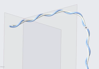

This month’s challenge is a part design problem based around curves and sweeps:
  • Using part modeling features, design a twisted wire pair that passes through at least three non-planar points.
  • (Bonus) Using Flat-to-Screen 3D Annotations, create parametric notes so that a user can modify the twisted pair. For example, diameter of the wires or rate of twist (similar to the pitch of a helical sweep). Is your modeling robust enough to handle dimension changes?
  • (Extra) Model 2, 3, or 4 twisted pairs that travel along the same trajectory, similar to a CAT6 cable.
  • (Super Challenge) Can you make two twisted pairs that twist around each other?
Post a picture or pictures of your work as well as the models. Indicate what version of Creo you used. This challenge is based on a technique I saw in a PTC newsletter 20 years ago, so this can be done using a standard license of Creo (or even Wildfire or Pro/ENGINEER). Note that this is NOT a cabling challenge; you should use part modeling features. However, you may want to consider Multibody Modeling. It’s also perfectly acceptable to perform the challenge in an assembly.

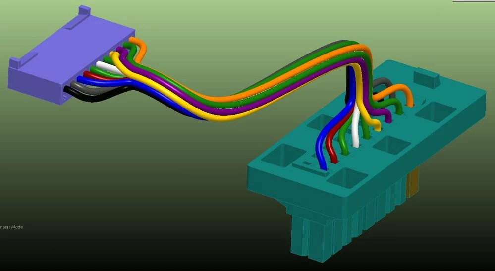

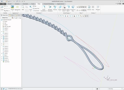

kdirth
February 28, 2024

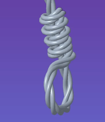

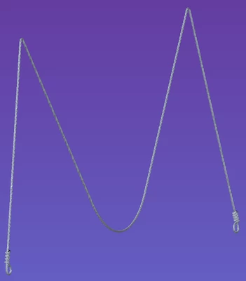

Here is on I did a few years ago for a model bridge contest.  It is a three wire twisted cable routed as a suspension bridge cable.
I will have to try the other bonus challenges later.

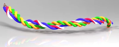

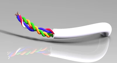

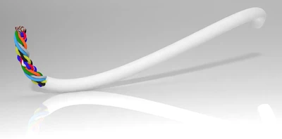

kdirth
March 12, 2024

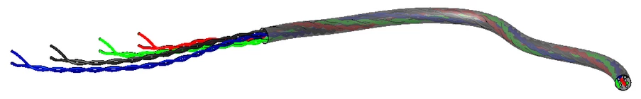

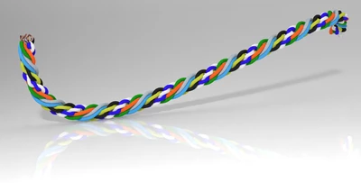

Here is an example of 4 twisted pairs, twisted in cable jacket.

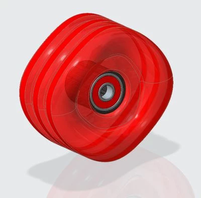

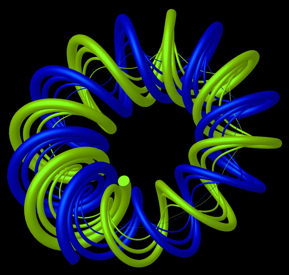

Patriot_1776
March 1, 2024

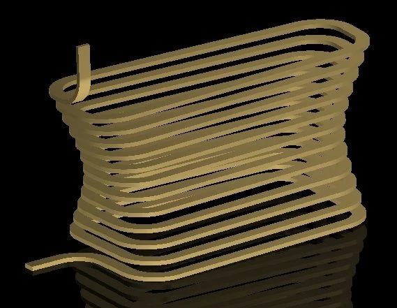

NGA_CHASSIS_62-8276_R01_ASM.JPG5417-1130_ml_rgt_asm-01.pngcoiled_spiral-01.png2021-06-29_WRAP_RECT_SPRING-02.jpg2019-04-29_LOBED_VOICECOIL-01.jpg62-8240_BALUN_TRANSFORMER.jpg2019-02-13_spiral_spring-01.jpg
Patriot_1776
March 3, 2024

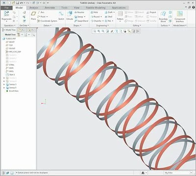

7-Bedrock
March 5, 2024

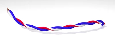

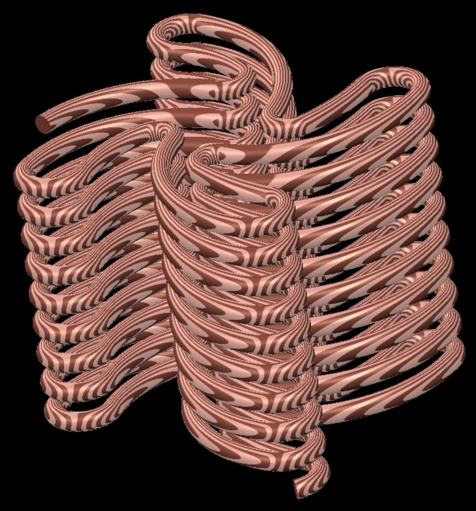

here is my first try
i tried to make it parametrable and robust as i can ...
made with Creo 4
March 5, 2024
Very nice!
March 12, 2024
Also did this many years ago.
I guess, if you know how this works the other variants are a laborious task.

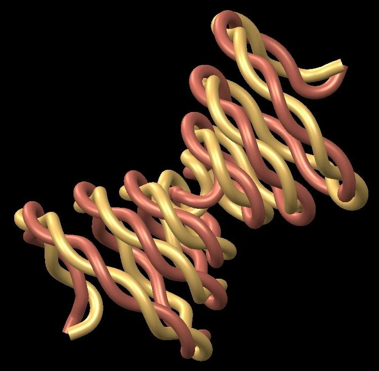

bbrejcha
March 19, 2024
Notice the braid weaves. Also from WEEK ONE surfacing but we often skip this one for sake of time.   This product goes into the body thru the femoral artery up thru to the heart to open things up a little. Can you name the manufacture of this part?
Sort of like the wave washer but this one wheel the military is interested in .... Rolls over anything eating rocks in it's path. Name the manufacture of this part. This example is from my Wednesday of the WEEK ONE Surfacing intensive.
grabbed this one off the design engine instagram wayback

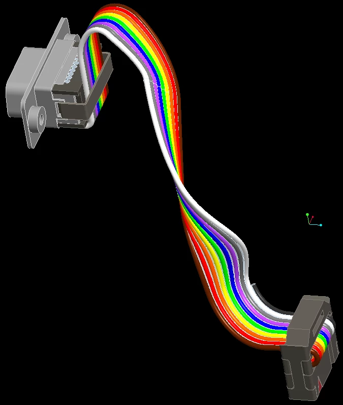

I could do it in Creo Harness Module too 😉
Bart Brejcha designengine.com

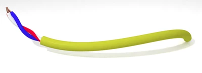

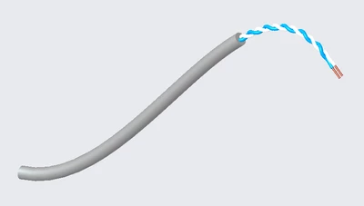

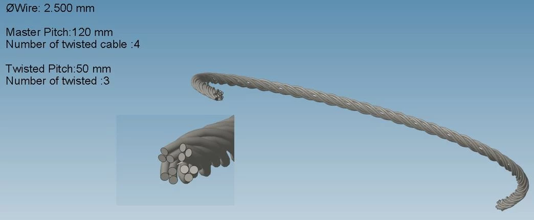

I did something similar a few years ago using Sweep in Wildfire.
I redid it using same approach but in Creo 8.
2 wires twisted no sleave.
2 wires twisted with sleave.
2 by 2 twisted no sleave using different pitch.
2 by 2 twisted with sleave using different pitch.
4 by 2 twisted no sleave using different pitch.
4 by 2 twisted with sleave using different pitch.
parameters/relations can be added to control the number of wires or the pitch.
Let me know if you have questions!
