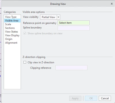

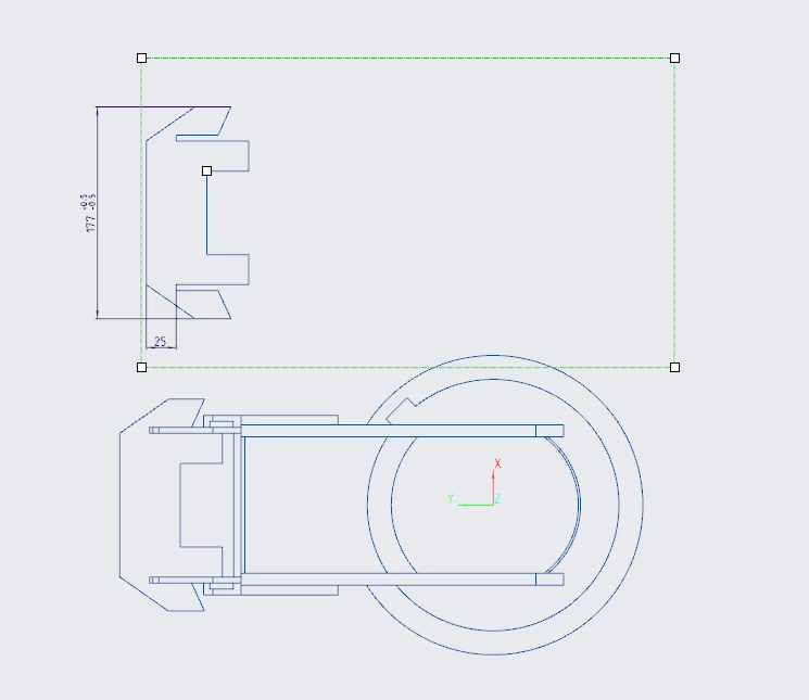

I have derived a drawing from a Multibody skeleton in Creo Parametric. Now I want to display only one body. This works, but then I have the problem that the view frame is still very large even though I only see one part, and I want to adjust this.
How can the drawing frame be reduced?

The easiest way is to change the visible area to a partial view.
