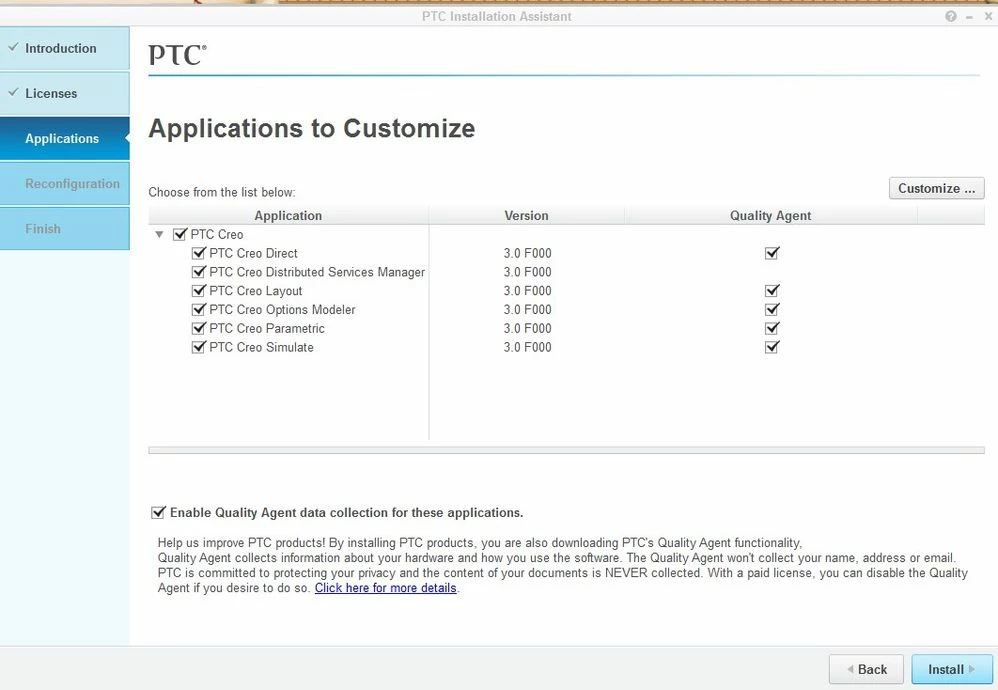

Hello again,
Yes this should be the one. But I can't seem to spot it therefore I assume is something that I have not currentl;y installed. Can't seem to find on setup either though:ptc.jpg
February 24, 2018
I believe Toolkit is not part of Creo. It is a separate development environment that allows one to create plug-in modules for Creo. It will not appear on the list of Creo modules and is separately purchased and licensed.
