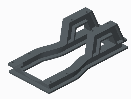

Hello All,
Please find below the attached file "frame.prt". This creo part has an parameter named password .
you can see the features of part only by providing the right password followed by model regeneration.
Good Luck.....

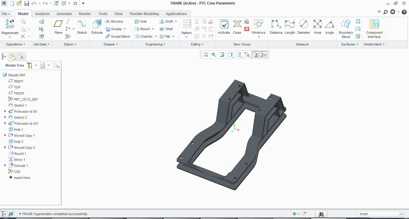

TomU
Oct 9, 2015 12:24 PM UTC
Piece of cake.  No password required.
It's worth repeating again, if you can physically open it, you can do anything to it.  There is no way to protect a Creo model once it's been opened.

HamsterNL
18-Opal
Sep 17, 2020 6:19 AM UTC
It will only work if you can stop us from editing the PRO/Program.
I just simply opened your part, edited the PRO/Program, removed the IF statement with the PASSWORD and regenerated the part.
It took me less than 3 seconds 🙂

HamsterNL
18-Opal
Sep 17, 2020 6:23 AM UTC
Open the part, edit the PRO/Program and remove the IF statement with the password, then regenerate.
