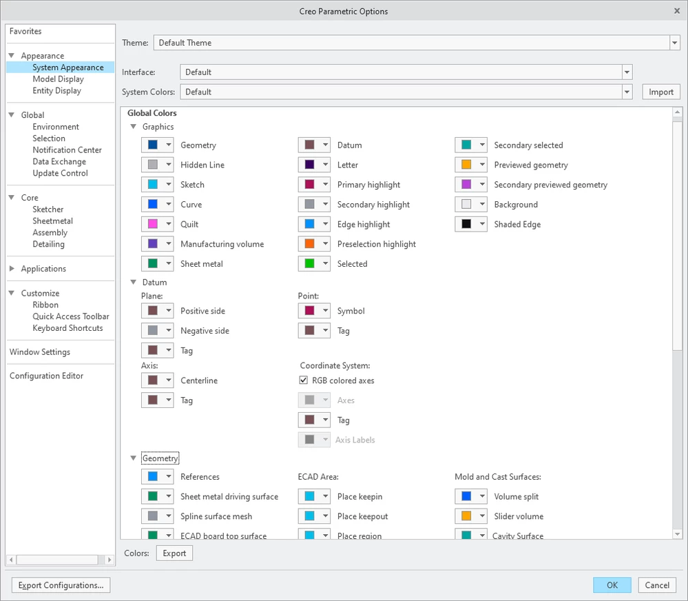

creo pen table (table.pnt) colors for cable parts
so I'm familiar with the help docs and other items in the help/support site on setting up a pen table (table.pnt)  but is there a specific "color" callout for cable part files?  or is it all wrapped up under pen 1?
I dont want to set PEN 1 to black because ive got other entities on the drawing i want to have in color.
Ive tried isolating the quilt_color to a unique pen and that doesn't work.  Any thoughts?  Or should I file an enhancement?

1.] please upload data set for testing purposes (Creo version ?)
2.] try to find which color is connected to cable parts
3.] if it is necessary you can "move" entitied plotted by pen 1 to another pen ... to do this you must know appropriate keywords
PetePickettII
Jul 3, 2024 5:51 PM UTC
Thanks Martin.   That "appropriate keyword” is what i am looking for specific to cable.prt files.  i have a feeling I need to place an enhancement, since the cables wire colors are all over the place.

please upload Creo files. This dataset enables me to see your "situation".
