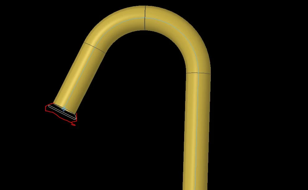

is there any way to create Flare at the tube ends in Creo piping module? please suggest.
I'm creating the new copper tube which requires Flare at the end. I was trying to add revolve feature but couldn't do it since it is in assembly mode - Refer the attached image.

I am not sure about piping, but you cannot "add" material in an assembly.
For part that gets crimped, I made two instances: as purchased and as crimped.
I used the as crimped in my assembly and as purchased on the drawing for the vendor.
In this particular case, I show both instances on the part drawing.
