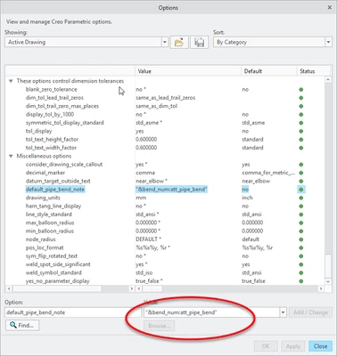

How do you show Pipe Bend numbers that reflect the same location as what is outputted by the repeat region?  I have followed the procedure in the help files and set default_pipe_bend_note to &bend_num:att_pipe_bend, but when I create my views the numbers do not show up with the bend notes.  We are using Creo 4.0 and the application Creo Piping.
Best answer by bwudtke
I figured it out.  My config was not set to correct value.  Should be as followed below:
bwudtke1-VisitorAuthorAnswer
October 3, 2019
