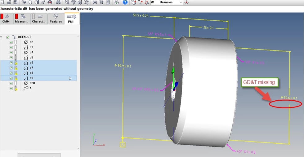

We are facing compatibility issues with Zeiss Calypso software where we intend to export the model based dimensions from creo to the software(Calypso). Currently, all Feature control frame annotations can be viewed via the Calypso but all the rest of the model based dimensions are missing.
Do you have any work instructions to export creo PMI informations to external softwares (CMM).

What version of CREO are you using?  I tried CREO 4 M060 & M090 and can't get the FCF to even show up.  It will show the dimensions and tolerances but the FCF & features won't recognize properly, for instance a revolve was used and it only shows a line instead of seeing it as a hole.  Then tried an extrude with 2 hole features still doesn't work then 2 extrudes still no good.  Chamfers it doesn't like either tried that multiple ways as well.  CREO 5 doesn't translate correct & CREO 6 crashes Calypso.  This all leads me to believe the translator still needs some work.

I am using Creo3 M120.
I believe so to. I have raised this to the local Calypso technical support team and they are working on it.
Will let you know if i get any update.
