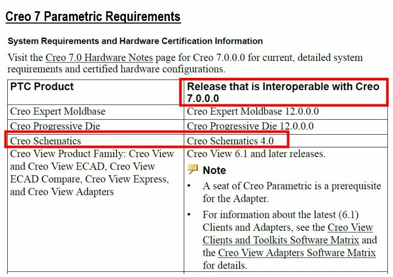

Creo Schematics 3 compatible with Parametric 7 if we use Teamcenter PLM?
RSD Users!
The below matrix says that, CS 4.0 is interoperable with Creo 7 parametric. What it means if we use different PLM (Teamcenter) other than Windchill? How this will impact us?
- We are using Creo Schematics 3, Creo 4 Parametric with Teamcenter PLM Planning to upgrade Creo 7.
- Parametric Any impact on Creo Schematics 3? Do we necessarily need to migrate to CS 4 or CS 7?

Hi Ramesh,
Creo Schematics has nothing to do with Teamcenter (this is for any version of Creo Schematics) - so if you used to work with Windchill, and you are transfer to Teamcenter -> you will loss the ability to check-in/check-out designs to your PLM system from Creo Schematics UI , including generation of secondary content during check-in.
Creo Schematics 4.0 works fine with Creo 7.0 , take into account Creo Schematics 7.0.0.0 was released - you should consider to upgrade .
if you comparing to CS3 there is new functionality and lot of SPRs were resolved....

Hi Ramesh,
