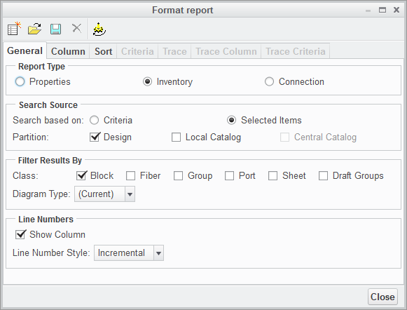

Hi all,
I can not make BOM (list of electrical component) in Wiring diagram in Creo Schematics. I need on sheet list of all component and their sum (like a mechanical BOM). Is it possible in Creo Schematics create BOM report? If yes, can you tell me how?
Ludek
March 24, 2014
Hi

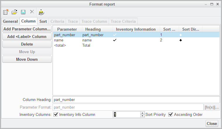

Choose Inventory

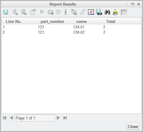

Assuming you want to display name and then report on something that can report total for example Part number set the inventory column priority
You will then get the total for part number 123 (2) next to each unique entry of name

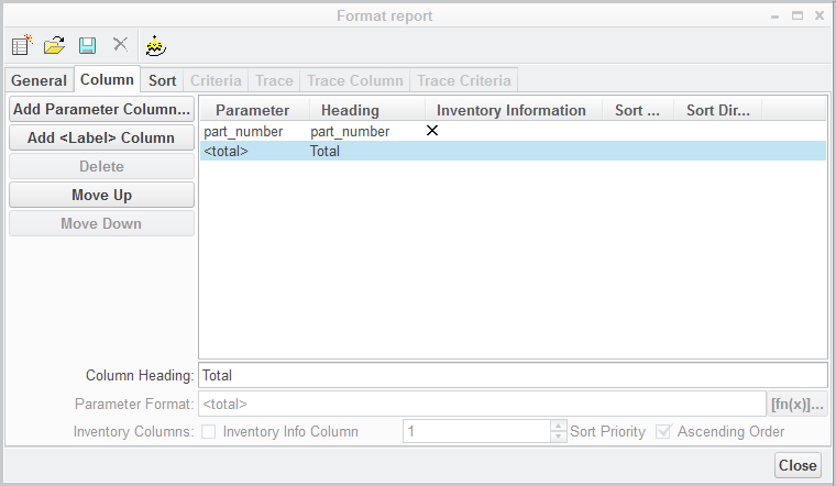

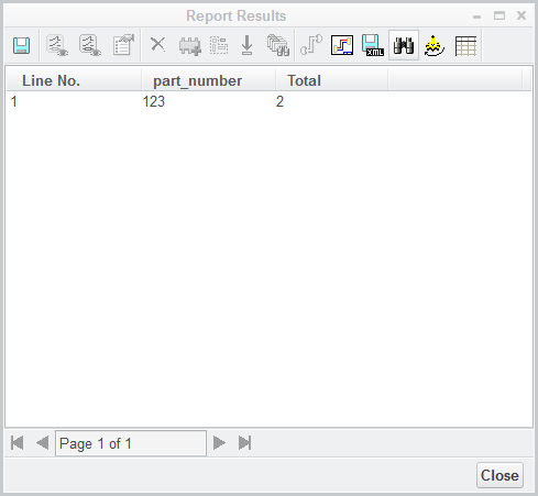

If you remove name and uncheck inventory column
the you will get the following results - 123 shown once and with a qty of 2
