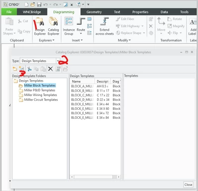

How do we customize the system to use our own drawing formats and component modules?
I noticed that the sample drawing template blocks have text fields, how do we get to or program these?
Sep 26, 2024 2:24 PM UTC
To Create a New Design or Catalog Template Sheet (ptc.com)
built in schematics help browser is the best to learn most things schematics once you learn schematics unique nomenclature.
