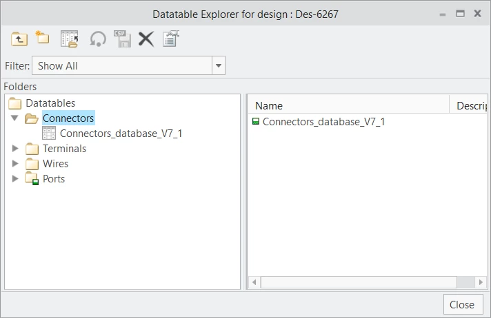

Hello everyone,
I am using schematics 7.0 as a ECAD and I have already an existing design where I would like to update datatables (picture 1) which are already in the central catalog. Also in the design I use a variable connector which is also in central catalog. At this connector I assigned default dataset (the one I would like to update)
The question is how to proceed now? I would like to keep the variable connector, only update the dataset.

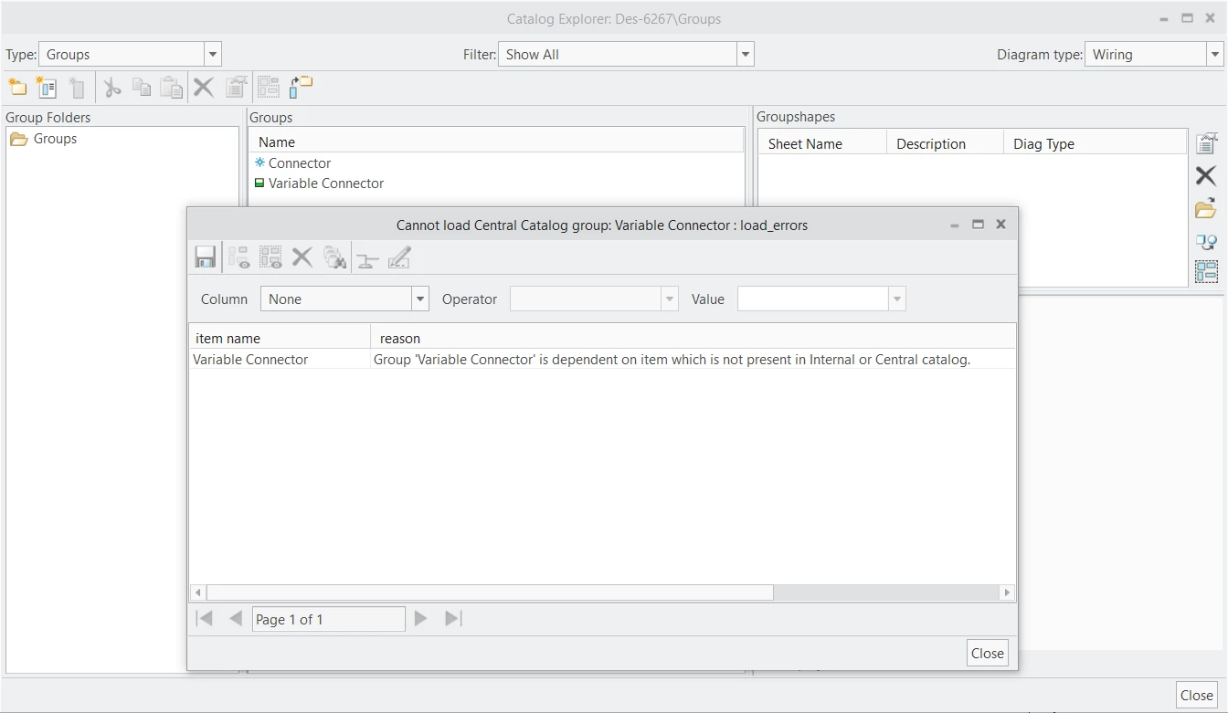

I tried to move with the files in central catalog folder but nothing is working. I can of course create a new dataset and delete the previous one from central catalogue, but then I will lost the connection with the variable connector (picture 2).

Alright I have a little update.... I somehow played with cmd and managed to create a password for my design. Now I can unlock the design with "unlock catalog" button and edit existing items which are in central catalog. So far this seems to be working as I expected.
The question is the "Admin" tab. I can't find it anywhere.... anyone knows what should I do to see it at the ribbon tab?

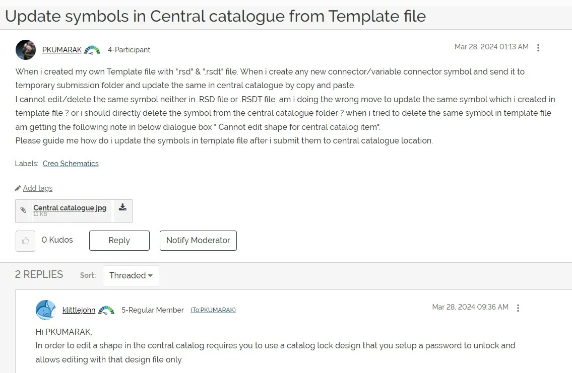

Hi all,
Yes the same struggle i am facing in Creo schematics where i have created template .RSD file and submitted all the artifacts to central catalogue by copy and paste from temporary submission folder,
Now i want to edit the artifacts in template file but its not letting me to do so. i have attached the same inquiry.
