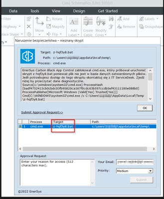

Hello Support,

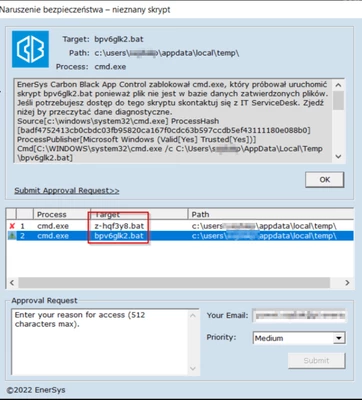

after installing Creo Schematics 9.0, when starting and closing the Creo Schematics application, our EDR software detects the .bat script that Creo wants to run every time. Each time it is a random name, for example "bg-hpul3.bat".
The file has a different name and SHA each time. The only common point is the file location, for example "'c:\users\username\appdata\local\temp\bg-hpul3.bat".
1. Do you know what the following script calls?
2. Is this script responsible for some Creo Schematics functionality?

Jun 3, 2024 7:16 AM UTC
I have this massage from Carbon Black

Jun 28, 2024 11:22 AM UTC
FYI...We use a custom .bat file to start Schematics. This sets all of our directories, path to the Central Catalog, any Java scripts, etc. Maybe that's why it create one every time you open it up.
I don't know if this helps or not.
