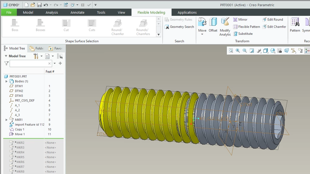

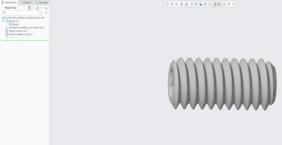

I downloaded an iges file of a vented screw. I would like to modify it to make it longer. It is currently 8mm long, and I want it to be 50 mm long. I have tried to mirror it as a way of elongating it, but the ends don't mirror correctly.
Is there a way to cut a section off? I could copy and paste the middle threads to get to my desired length.

You can probably model that from scratch faster than you could modify the STEP model to accurately represent a longer version.
Here is a copied and moved thread geometry to "lengthen" it. If you index the translation value, you can align the threads, so they pass a cursory view. This is a total hack for a cartoon only. If you need the actual geometry, build a model from scratch.

Not the prettiest way to do it, but:
  • Copy the surfaces of threads, bottom & vent
  • Trim top end of copied surfaces 6 mm from bottom.
  • Solidify surface
  • Pattern copy by directtion - 11 members 4.2 mm (6 threads) spacing
  • Pattern cut
  • Pattern solidify

No, actually, the threads DID mirror correctly, it did EXACTLY what you told it to do.
Besides, IGES files are cr@p, use STEP files if needed.  Let me guess, garbage McMaster-Cr@p model?
Don't waste time on this, remodel it the length you want with simplified threads instead of helical ones.  ASME B18.3-2012 gives you all the data you need.
