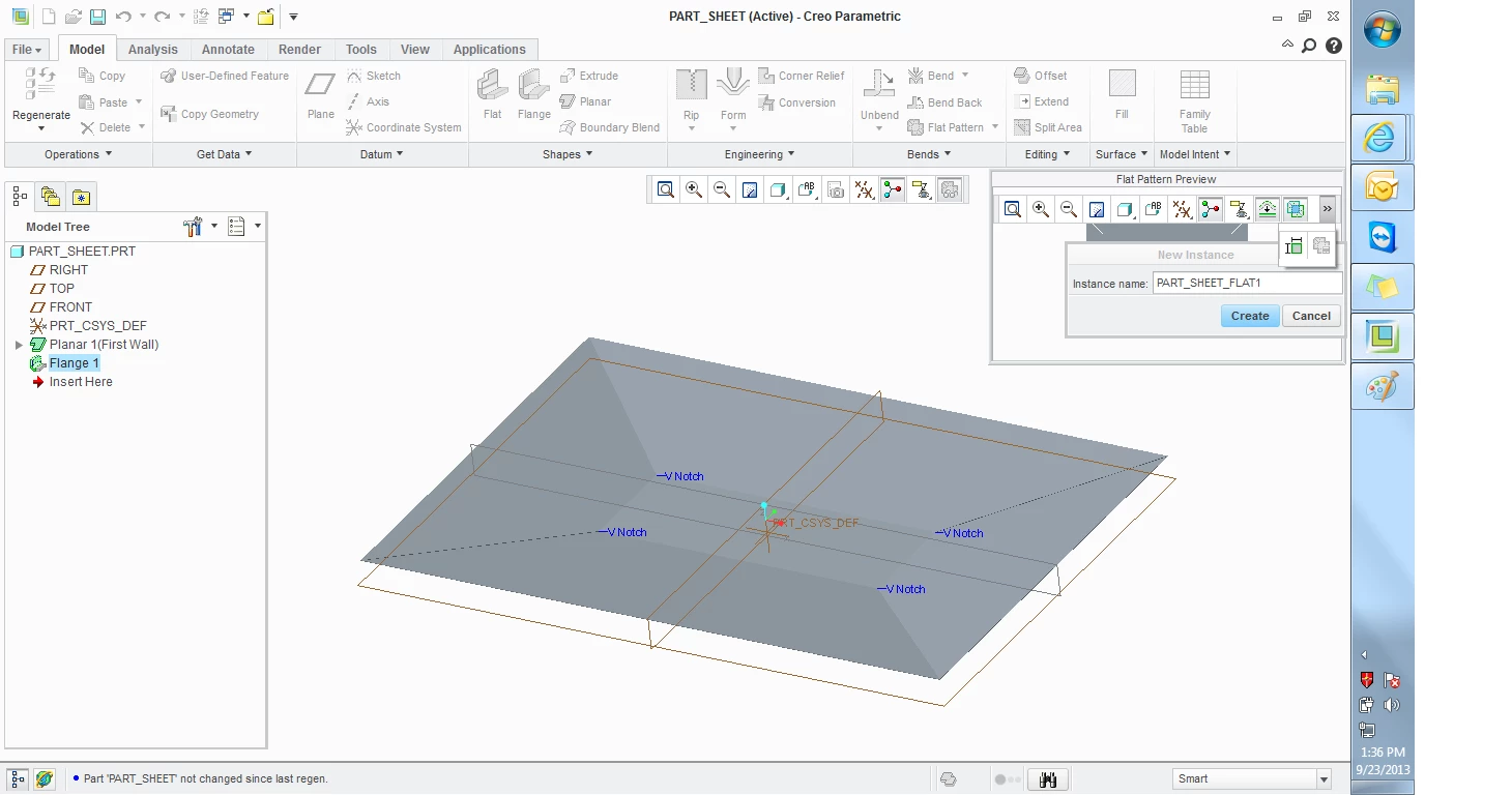

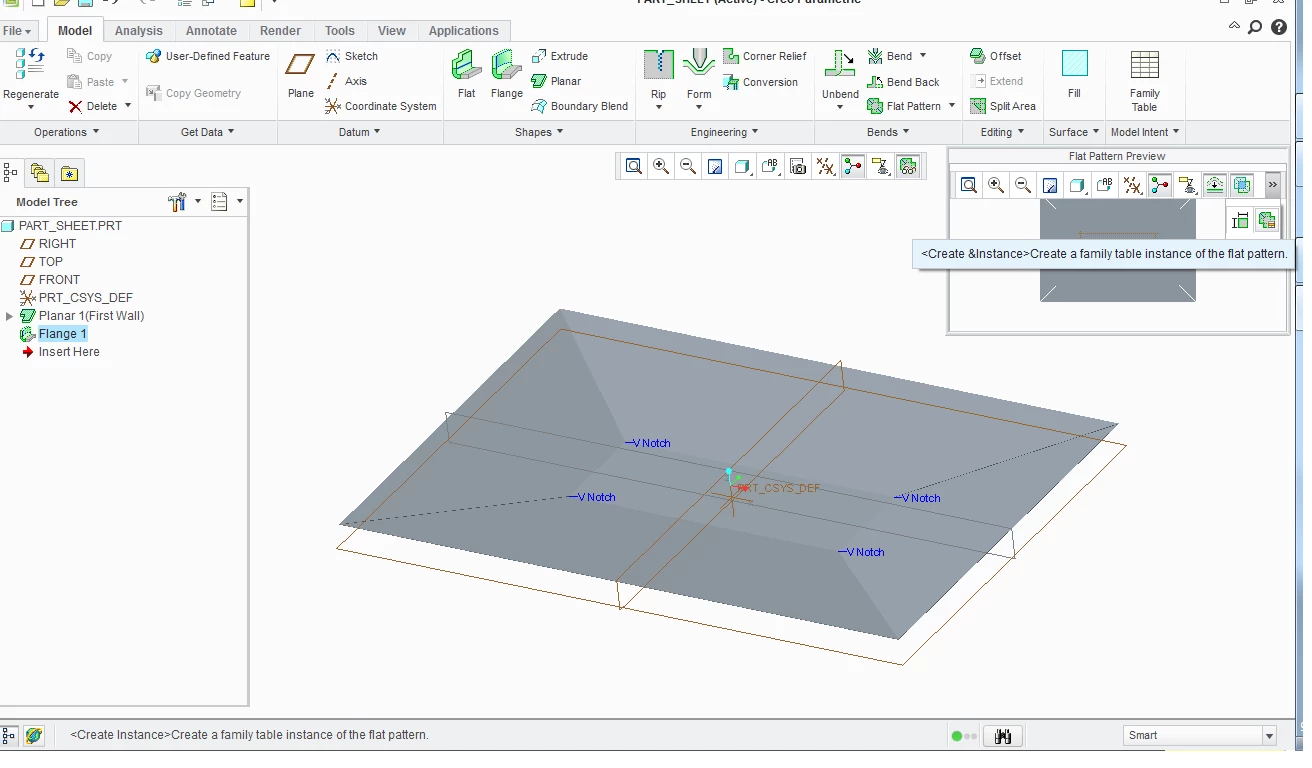

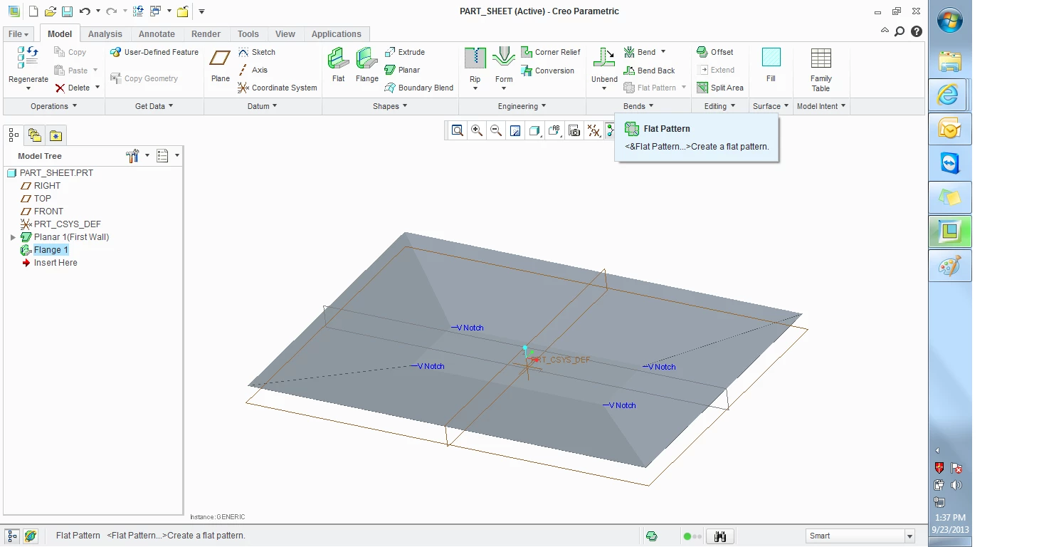

What i have understand through Create flat instance through Creo sheetmetal minimizes the work of creating flat pattern instance but at once the instance was created , i dont why the flat pattern command is get hidden, anyhow we can tolerate this by saying its restricts the user to create 2 flat pattern instance,
but while working with drawing , its again back work we have to bring back the family table flat pattern instance to do a general flat view with the projection views but its take enough time to go through the process,, especially user get conflict by the 2 views
Why could not PTC include Instant view at the same time ,, so there will not be 2 files or instances or this conflict,,
because the basic requirement is to show case the plat pattern view in Drawing ,,
i request PTC to improve this Command feature ,, dedicated to user not to "Software developer Language"
