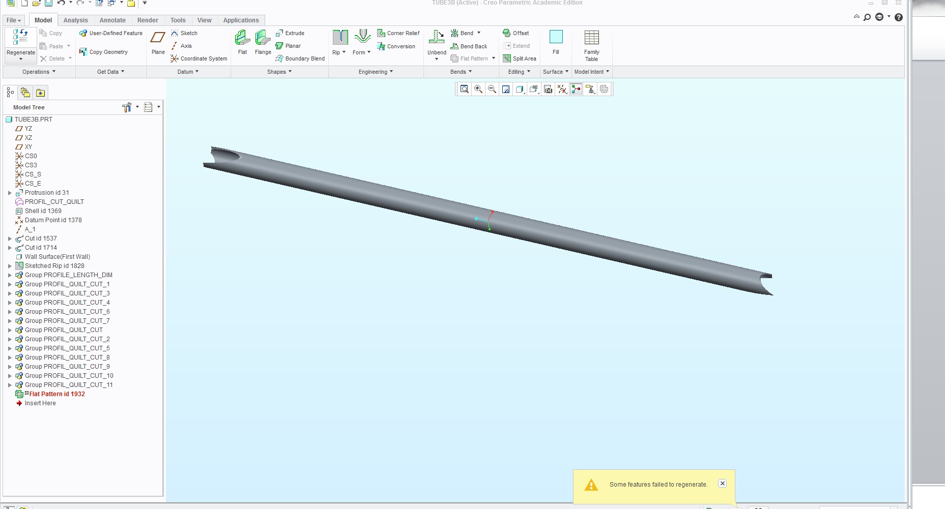

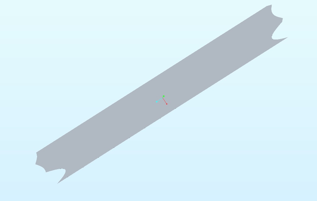

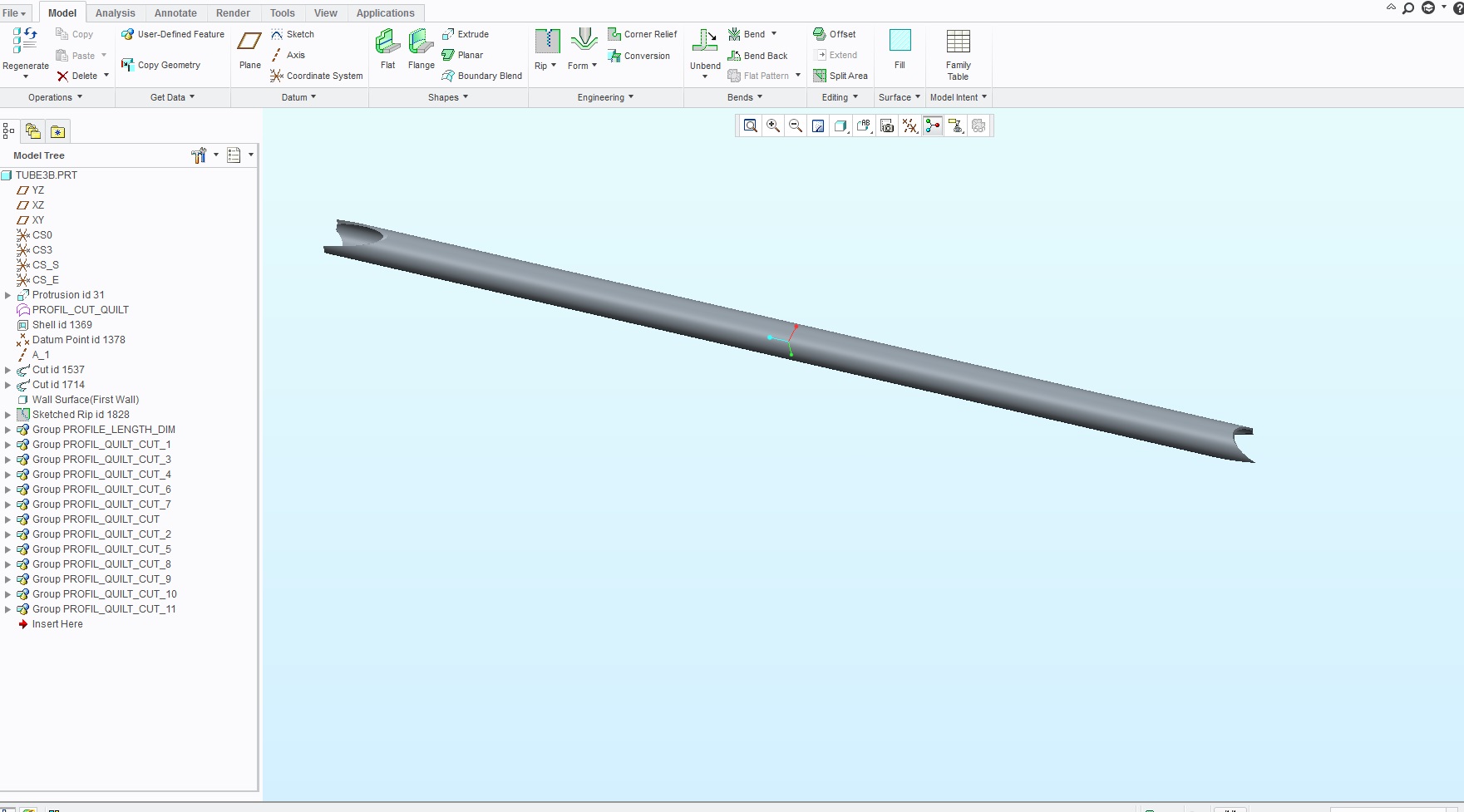

We are trying to unroll tubes from a chassis created in the AFX extension in order to produce templates for tube notching. The way we do this is by opening up the part for the tube and operations>Resume all to unsupress the flat pattern ID. This works for some of our tubes but fails for others. Does anyone know why this occurs? For example:
1) Rolled
2) Unrolled
This works for the tube above but fails for the tube below. Flat does not regenerate when unsupressed.

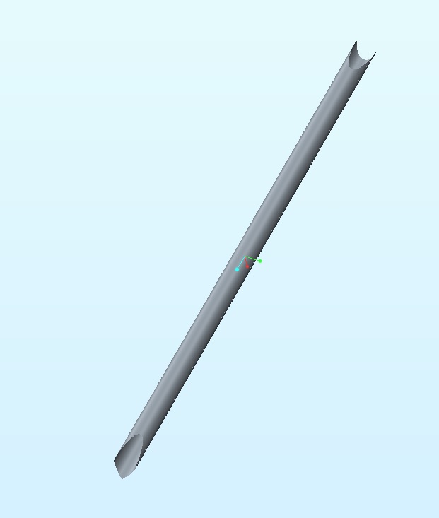

1) rolled
2) Failure to unroll
So the question stands What would allow one tube to display the flat when unsupressed but cause the flat to fail when unsupressed for another. Both of the tubes have multiple profile cutouts in each end. Looking to resolve this as soon as possible.

Flat patterns can be very fussy. You need to go in and redefine the flat pattern and see if you can find the error.
I tend to use the bend and bend back more often for simple operations such as this.

I haven't been able to do any of this properly. I can't bend back any of the tubes (ones where the unsupressed flat pattern regenerated and ones where it didn't). Also I can't get sketched rips to work on any of the tubes, including the ones where the flat pattern already exist. To do a sketched rip you just sketch a line along the outside of the tube if i'm not mistaken? Are their any video tutorials on this?

That is my experience as well, Hafeez. I find it absolutely frustrating to try to use the advanced features where rip rarely does what I want it to do. However, some people can really shine with the package because they have learned exactly what to do and what order to do them in. I have gotten better, but I reserve sheetmetal for only simple fabrications.
I am going to suggest you want to start your tubes from a revolve (1st feature) that you know you can "unbend". Next "bend back" and create your cuts. Be very aware on which side you want the feature to intersect and be consistent. As you you add new cuts, be sure to test the Unbend just on a temporary basis by deleting or undo-ing the feature. As long as it will unbend, it should be able to flat pattern as well. You might have to turn off the bend relief features in the options dialog.
Are you actually forming the tubes and welding the seams or is there another reason you want to see the flat pattern?

Try changing the part accuracy, possibly to absolute accuracy so that it matches across all the parts in the assembly.
