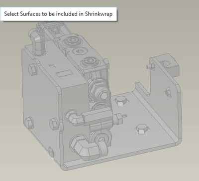

Creo Shrinkwrap fail with error "Feature aborted. Geometry was overlapping."
I have set the absolute accuracy to 0.0001, still i face the issue.

vrajan10-MarbleAuthor
Jun 25, 2025 8:29 AM UTC
I am trying to shrinkwrap an assembly containing quilts and solid parts
I tried all options (e.g., surface subset, solid, automatic)
Jun 26, 2025 7:33 AM UTC
Hi
this error message lead to some articles that pertain to disparities in accuracy and overlapping geometry.
Here is what you can try :
  • Issue can be caused by different model accuracies for each of the components. Hence check that the accuracy is the same for all components and/or
  • Check the geometry errors > Info > Geometry Cheks
