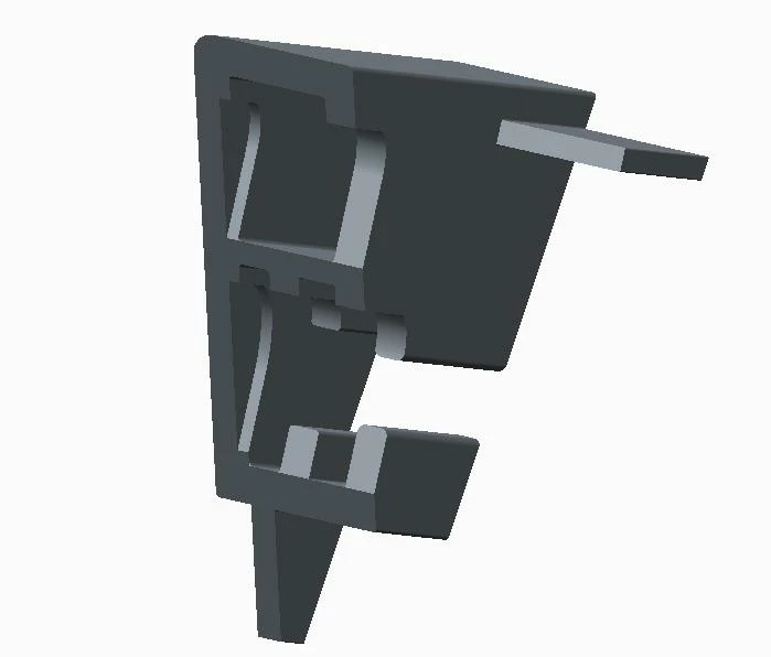

Hi all,
Can anyone assist with 'Element Incompatibility' Issue?
I have inherited a model featuring fairly complex extruded sections of a frame.
I have checked geometries, interfaces and constraints in Creo Parametric 2.0 design, such that it allows me to enter Simulate with no error.
However, when I try to AutoGem the model, I obtain the error below, for certain curves (edges).
(Orange dot):
AutoGEM has detected an element incompatibility across the
highlighted curve. Adding points to the curve may help.
In some cases, re-creating the curve and adjacent
surfaces may be required.
Does anyone know if there is a technique I can use to try and remedy this incompatibility , and what may be the root cause?
There does not seem to be anything fundamentally wrong with the design of the parts.
I tried to create a Modal analysis, but would not run either
Any adjustment to the parts would mean a significant assembly re design, but if I know which direction to go then it will be worth it.
Maybe certain Sections are not compatible with Simulate?
An example section (for which this error exists) is attached.
Such section is part of a large frame assembly, joined at mating faces.
Any advice appreciated. Many Thanks
