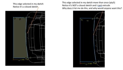

Hi Guys,
One thing that always kind of bugs me in Creo was when in sketcher, trying to sketch an extrude or something.
 When selecting an existing edge ...why does Creo let you pick the same edge more than once? (using project in sketcher)
When that happens you no longer have a closed sketch, and have to remove it.
In other software I use, if you click an edge to use in your sketch, it sketches it. If you clicked that same edge again (say by accident) , it would removed it.
So there was never a time it would have multiple sketched features one on top of another.
Is there a setting to not allow you to have multiple edges of the same edge in your sketch.
Maybe its the way I am used to sketching things, but i have NEVER had the need or want to have the same edge picked more than once when in sketcher.

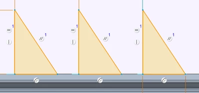

I often select twice to use more than one segment of the edge.  I use the corner command to trim the lines to other lines.
I may also find that I need another segment after trimming the first projection...
February 25, 2022
True, I do the same, BUT when I click the segment of the line for the next triangle, its in a different position on that line. Not right on top of the original segment I had first selected.
I guess you could select that line 3 times in the exact same spot before you construct anything, but in my mind, that would be an odd way of doing that sketch.
