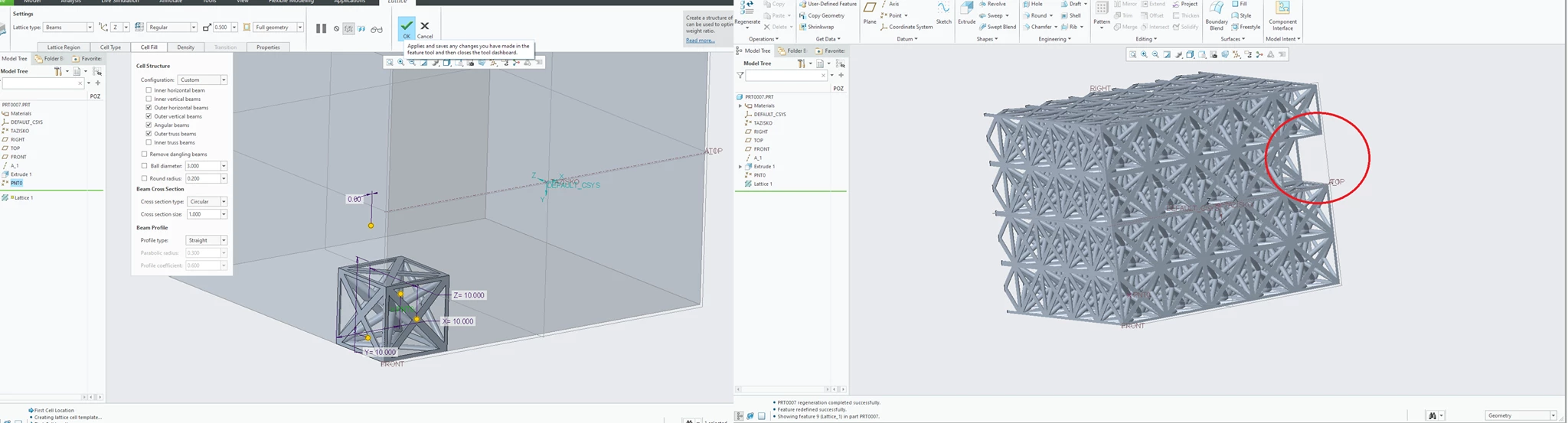

I wanted to create Lattice structure with dimensions 50x50x50mm. Dimensions of cell are 10x10x10 and cells starts on the corners. When I created this structure some of cells are still missing... Why ? This missing cells are random. If I regenerate structure (or recreate) others cells disappear.
Why ? and how to fix it ?
Thank you for your answer.
Here is the screenshoot how it looks like:

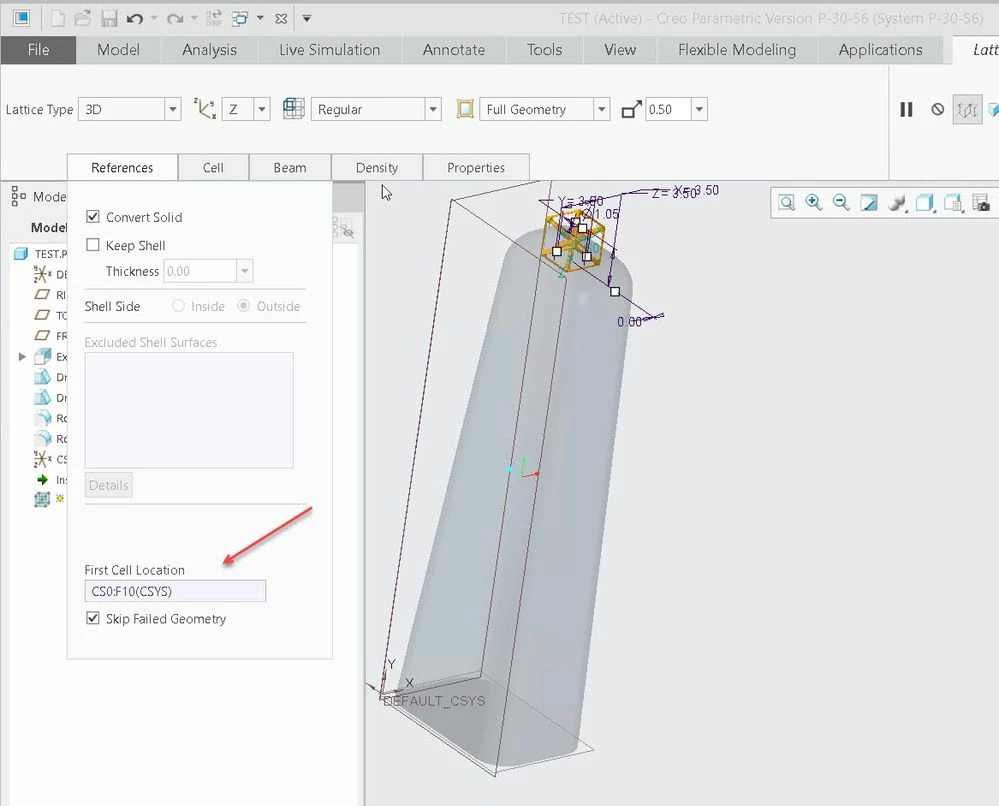

Just try to change the first cell location .
Just use slightly offset csys  to default  csys  as first cell location,  if deign permit
