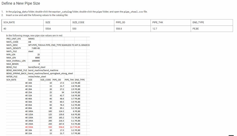

As a designer engineer in rolling stock, I'm considering the use of Spec-driven piping within Creo Parametric 8, and working within EN standards I wonder if it is possible to define pipes with an alternative to the API schedule rating. For instance I got a copper pipe OD12 x 1mm thickness within EN 1057 which does not use schedule rating, so I don't know how to fill in the SCH_RATE in the Pipe Master Catalog csv file. Can I leave it empty? The alternative I thought is to fill the field with a made-up number/code but I'd rather to avoid this way. So does Creo Parametric Piping take in consideration piping out of API/ASME specs?
Thank you all in advance for your help!
