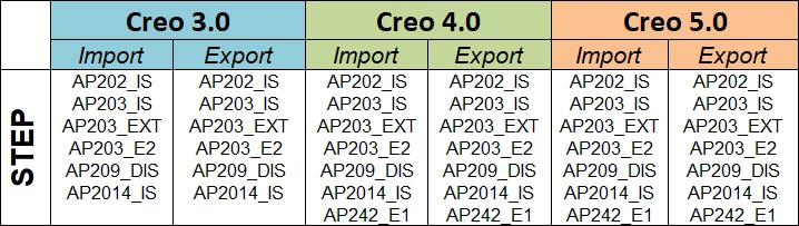

Jul 28, 2018 9:05 AM UTC
I need Import procedure for AP242

Aug 10, 2018 1:11 PM UTC
Article - CS134024 describes which data exchange versions are supported in different versions of Creo.
HamsterNL
18-Opal
Aug 10, 2018 1:25 PM UTC
Are you on Creo 3 perhaps?
