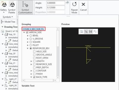

I would like to create a weld symbol in creo drawing. If there is any standard symbol available in library please suggest that name.

for the second one use comb_v_bev_sqr_fil.
For the first one, I don't think they made a fillet version with a backing symbol, so you may need to create your own. I would start with the fillet and either create a new symbol or just sketch in the backing or make a new symbol.

Thanks for the suggestion but it is not showing backing , actually it shows the melt-thru. That's my main concern how to create that symbol if we don't have it in our library.

You'll have to create your own. I would suggest start with the weld symbol closest to what you want and modify it and save with a new name.
Symbol creation is not something I have had to do many times.
