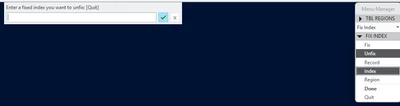

Can you please elaborate more. I know that if you delete fixed part from assembly you need to unfix the part which was deleted like this. That way you can "reuse" the table line

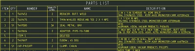

What I did to preserve the BOM numbering was create a family table of 99 items that have the item set for each one for position 1-99. If you delete item 5, you add to your assembly Deleted Item 5 part, which is an empty part, and then the BOM will show that item as DELETED in the name field and be item 5 in the index. Had to use ITEM 5 instead of just DELETED in the Number field as that would merge the items to a single line.
