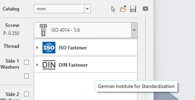

Hi, we have 2 languages and we want to show catalogue group name in two language using help text option from translation files.
For subcomponents I think we can use Subinfo option.
Can we use same for catalogue groups ?
OliverGräbner
May 8, 2024 7:39 AM UTC
you can use the ifx_translation for group and helptext as well.
Look at '#screws din_fastener' for an example.
